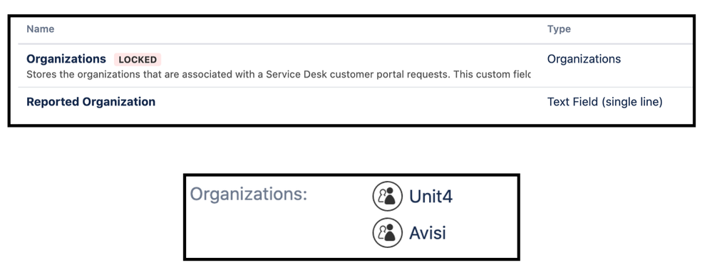

Organizations is a custom field provided by JSD of type Organizations (select list, multiple choice)
Reported Organization is of type Text field (single line)
Although several Organizations are possible, in practice 1 will always be chosen.

Gustavo FƩlix
October 1, 2020
Ok, two things.
1) Caused by: com.atlassian.jira.workflow.WorkflowException: Error occurred while creating issue. This could be due to a plugin being incompatible with this version of JIRA. For more details please consult the logs, and see: http://confluence.atlassian.com/x/3McB
It seems that your version is not updated. I've never seen that error, but that webpage says that.  Maybe something you need to check out.
2) I didnt read that you were using jira service desk, I thought it was Jira Server . So , I cant replicate the use of "Organizations". It seems from what I've searched, is a select list, but I'm not sure how to handle the field.
I would try
def cfOrganization = customFieldManager.getCustomFieldObjects(sourceIssue).find {it.name == 'Organizations'} as List
Before the setCustomFieldValue , add a
log.warn "cfOrganization.get(0)"
Just to test if it logs something.
But again, I dont have JSD , so I'm almost guessing here.
My suspect is that you are trying to set an Organizations type field to a String field, so that has to be converted somewhere.
I hope this helps you.
