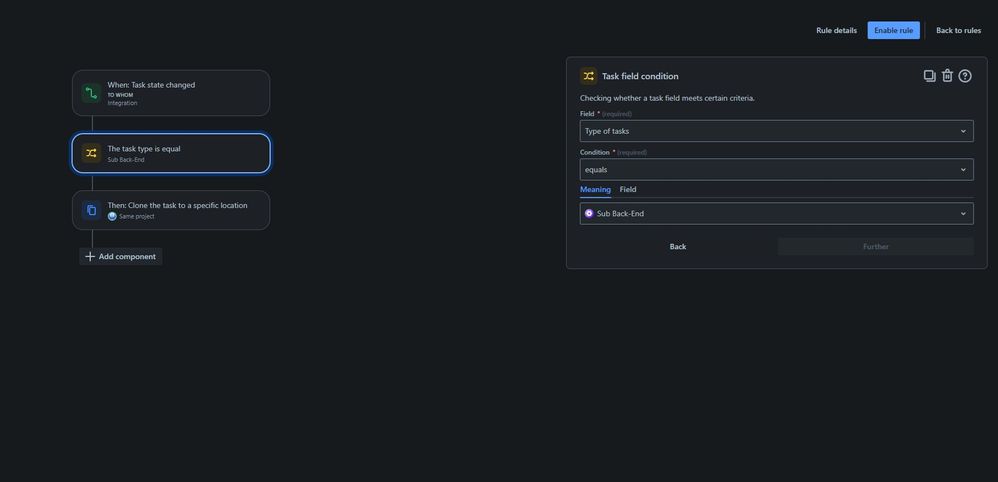

There is a task, there are several different subtasks in it, some of them need to be cloned when their (subtasks) status changes. How do I do this?

Try to explain it again. There is a task, it has subtasks. I need to transfer the status of a Subtask to, say, "In progress", and under this condition, the subtask for which I changed the status should be cloned there, with the same parameters and data. By changing only the task type field.

It turns out that I configured that when the task status changes, the task should be cloned, with the same parent, etc., but it does not work

A screenshot of your current automation rule configuration would also be super helpful in troubleshooting this!

Thanks for providing the screenshot and clarifying your goal! It looks like you want to automatically create a new "Back-end" sub-task whenever a parent task transitions to the "Integration" status.
While it's technically possible to clone the existing "Back-end" sub-task using automation, I'd recommend using the "Create sub-task" action instead. Here's why:
  • Fresh Data: Cloning would create a copy of the existing sub-task with all its current data, which might not be what you want if the intent is to start a new "Back-end" effort. Creating a new sub-task ensures you have a clean slate.
  • Customisation: The "Create sub-task" action allows you to pre-fill fields like the summary, description, assignee, and more. This gives you more control over the new sub-task's initial setup.
Here's how you can configure the automation rule:
Automation Rule Configuration
  1. Trigger:
    • Event: Issue transitioned
    • Status: Integration
  2. Condition:
    • Condition: Issue fields condition
    • Field: Issue Type
    • Operator: equals
    • Value: Task (Or whatever your parent issue type is called)
  3. Action:
    • Action: Create sub-tasks
    • Configuration:
      • Issue Type: Sub-task
      • Parent Issue: {{issue.key}}
      • Summary: Back-end
      • Other fields: Customise as needed.
This rule will trigger whenever a Task transitions to "Integration". The condition ensures that a new "Back-end" sub-task is only created for parent tasks of that type.
Give this a try and let me know if you have any questions!

Your rule will only work if the main task (which has subtasks) is transferred to the status I need, right?
But I need to transfer the status in the subtask and have it cloned
AkLike
August 8, 2024
AkLike
August 8, 2024
The error that I have is:
Parent issue ID: '15682' / Key: 'SPM-172' can not be sub-task. (issuetype)
