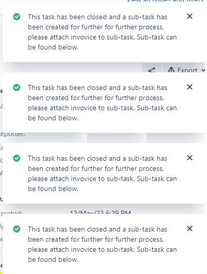

I tried UserMessageUtil, and there are two issues I'm facing, first I have to refresh the page in order to see the message, and the second problem is it displays four pop-up messages instead of one. Any idea how can I fix these two issues?
import com.onresolve.scriptrunner.runner.util.UserMessageUtil
UserMessageUtil.success("This issue has been closed and a sub-task has been created for further process, please attach invovices to the sub-task. Sub-task can be found below.")
Thank you for your help.
KC Wong
May 12, 2022
You are right, UserMessageUtil does not show the message unless the page is refreshed... but for your case, it should.
The create transition in the workflow has a post function to fire "Issue Created" event for listeners to catch, and afterwards the transition will refresh the page.
Are you somehow creating subtasks without triggering the workflow transition?
As for the message repeating, I haven't been able to reproduce it. Try checking the logs on the listener to see if the listener got fired multiple times for the same issue?
Like • Shah Baloch likes this

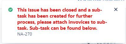

You are right, I was creating sub-task manually. It works if an auto sub-task gets created. I updated the text color and size to make it more visible. One thing I'm unable to make work is the hyperlink for the issue key. Issue key displays but it's not clickable. Any idea?
Here is the script
import com.atlassian.jira.event.issue.IssueEvent
if (issue.issueTypeObject.name == "Sub-task") {
UserMessageUtil.success("<h3 style='color:red;'><b>This Issue has been closed and a sub-task has been created for further process, please attach invovices to the sub-task. Sub-task can be found below.</b></h3>"
+ issue.key)
KC Wong
May 15, 2022
You need to use the <a> tag to create a hyperlink:
+ "<a href='link to issue here'>" + issue.key + "</a>")

Shah Baloch
May 20, 2022
Thank you @KC Wong I was trying hyperlink but I was not including those plus (+) signs at beginning and end of the hyperlink so that's why it didn't work. I followed your steps and it works. I'm adding the final version below for those who don't have coding experience like me.
+ "<a href='https://myjira.com/browes/$issue'>" + issue.key + "</a>")
One last question, is there a way to include the parent issue key in the popup? Like I add " This issue NA-60 (parent issue key) has been closed". Is that possible?

KC Wong
May 22, 2022
issue.parentObject.key
