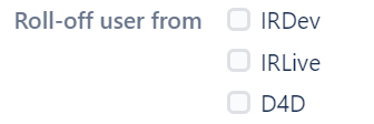

So here is the checkbox, so if they select the option D4D then then an error message should be thrown to say D4D PID has to be filled in.
