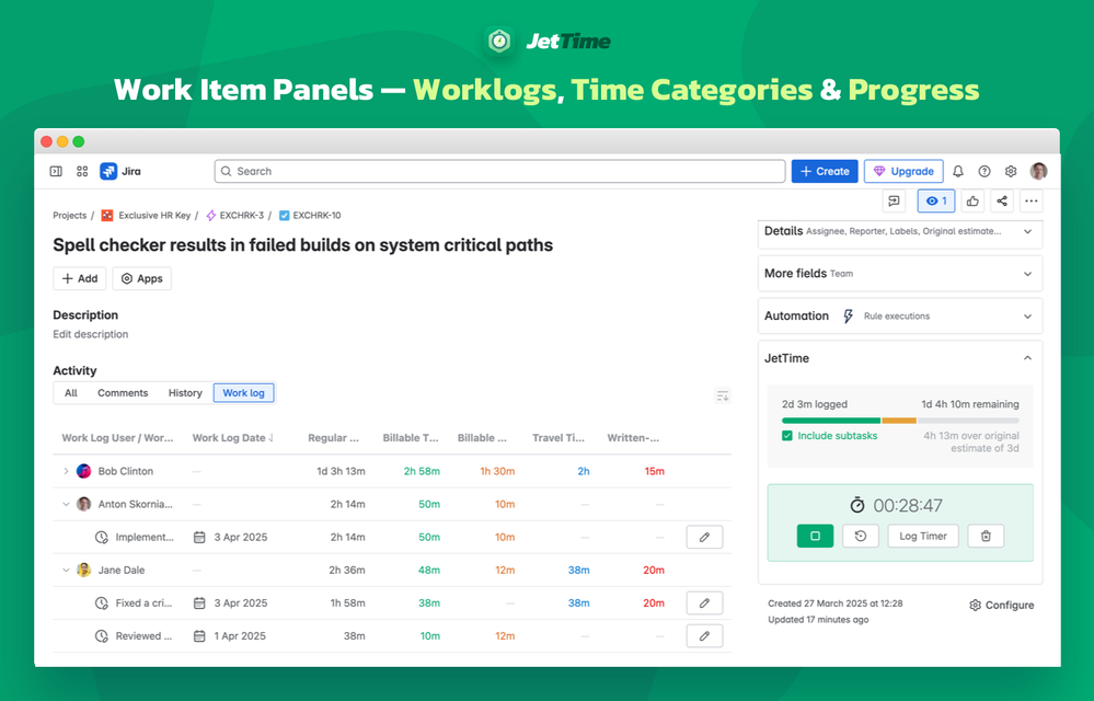

2. How you log the time — this is where the details make or break the sync. Whatever tracker you pick on the side that syncs, it has to log time in a way the sync app can actually carry across. Two things matter most:
  • It must write native Jira work logs — real entries on the issue via Jira's own work log API, not time parked in the app's own private layer. A sync app can only pick up what actually lives on the Jira issue.
  • The real author has to be on the work log — the person who did the work, as the native Jira author. If the tracker hides who logged it, your reporting on the other side loses the one thing you need: who spent the time.
  • Timers, since your engineers work from the issue — start/stop on the issue they're already in, then it becomes a real work log. That keeps the overhead you're worried about near zero.
This is worth checking carefully, because it rules some options out. Tempo does its job well — but for this exact setup it's not the fit: it keeps time in its own worklog layer rather than as native author-attributed Jira work logs, and it has no start/stop timers on the issue.
The combination you actually want — native work logs + real author + timers — is what JetTime (a third-party Jira app) is built around. Every log is a native Jira work log attributed to the real author, and timers start right from the issue — so a sync app has clean, correctly-authored data to pick up.
Practically: you'd install it on the agency's Jira (the source of truth) so the work logs land natively there. If you also want richer reporting on your own side — group and roll up by user, date, account, custom fields — you can run it on your instance too.
  • Start/stop timers from the issue, log straight into a native Jira work log
  • Real author on every work log — nothing hidden
  • Reports and worksheets: filter, group, roll up by user/date/account/custom hierarchies etc, export
  • Runs on Atlassian — your data stays inside Atlassian Cloud, we don't have access
