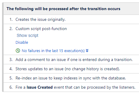

Here's the round robin script. I have it set as a scripted operation on issue post-function upon issue creation:

Notice the changes you made to the lastIssueIdWithAssignee variable. Here, I added the condition, " &&  !foundIssue.get("customfield_20500")". This custom field translates to a user picker called Assignee Change Author, which I created along with the listener as per your other suggestion. If a user manually re-assigns an issue, their name will populate to that field...otherwise, the field will remain empty.
So now this script looks for the latest Certification issue, with an assigneewhere the Assignee Change Author field is empty.
Thanks again for all the help!!

Hi @Ian Balas ,
sorry, please try to add your custom field Original Assignee to the issue create screen.
Please also try to check the log, if there's some error - probably there is one, because both the fields are not working.

I apologize, it couldn't work. The main problem is with usage of setCustomFieldValue, I just assumed it behaves the same as setAssignee.
What needs to be set:
  1. Original Assignee field is on the create issue screen
  2. Post-functions are in the correct order
Here is the updated script (xxxxx needs to be replaced by your id) - I tested it and it works for me now.

@Hana Kučerová I think we're finally all set! It works 100% the way we want it! I even hid the original assignee field from user's view (but still have it on create screen) and the script still works as expected! Thank you very much Hana, I'm beyond thankful you stuck this out with me all the way to the end :D.
