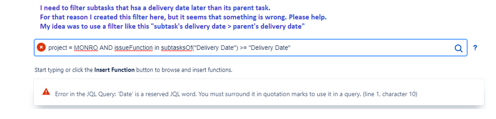

I need to filter subtasks that has a delivery date later than the parent task. I'm trying to do a comparison between dates, but I'm not able. I tested this: project = MONRO AND issueFunction in subtasksOf("Delivery Date") >= "Delivery Date" without luck
Please see the following image for more information:

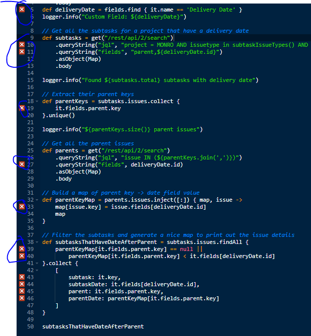

Let me ask you in regards to debugging. I got several errors after execution:
image.pngIs there good way to debug that you can recommend me?
Here an example of one of the errors I got:

Those "errors" are reported by our type-checking code which tries to report possible bugs in your code.
Unfortunately it can't always figure out what types are being used so unless we add in additional type hints we get these errors even though nothing is wrong. I've just become lazy with adding in the relevant type hinting.
The following code should not have those errors:

As an aside, your query doesn't work because the text between the subtasksOf() brackets must be a valid JQL query, in other words something like this:
issueFunction in subtasksOf("project = MONRO AND 'Delivery Date' >= now()")
Additionally, the "issueFunction in subtasksOf" clause in your query returns a list of issues, so you can't then compare the results of that clause using >=
