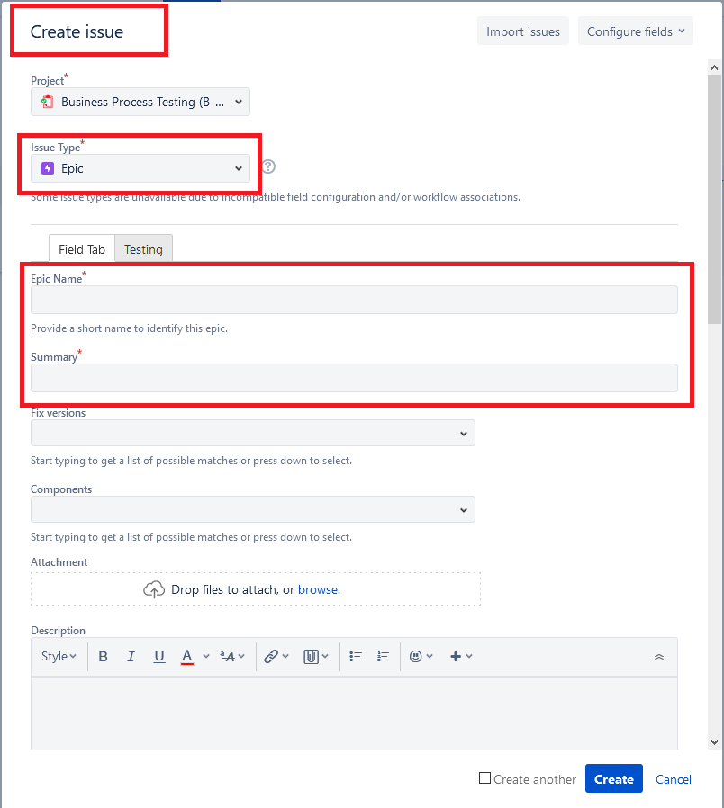

Hello @Sameer Bhangale
When you update an Epic, the edit screen is used. When you create an Epic, the create screen is used; the two screens are not the same.
Double check that you can create an Epic via the web interface in that project, and that the Name and Summary fields are there on the create screen, like this:
If you have already double checked that the Name and Summary fields are on the Create screen and that one screen is used for creating, editing and viewing an Epic, then it might be a coding issue in the body of the request. Try removing the inverted commas around the field definition, like this:
