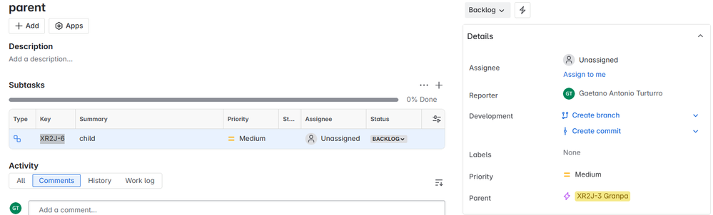

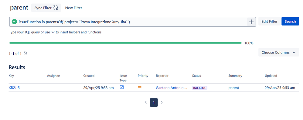

Screenshot 2025-04-30 104427.pngScreenshot 2025-04-30 104627.pngScreenshot 2025-04-30 104537.png
I'm sending you the screenshots that show the Enhanced Search, as configured following your suggestion, is returning no results.

Your "parent" filter shows that one issue was found (XR2J-6) that is a Parent of issues in the specified project.
  1. What type of issue is XR2J-6?
  2. Is that an accurate result, or do you think more issues should be returned?
Your "grandparent" filter shows no results.
  1. Does XR2J-6 have a value in its Parent field?
The issue image you provided doesn't include the key of the issue being viewed.
  1. Is that XR2J-6?

  1. XR2J-6 is a sub-task.
  2. The parent issue appears correctly in the search results, unlike the grandparent.
  3. The hierarchy is:
    Sub-task (child: XR2J-6) → Task (parent: XR2J-5) → Epic (grandparent: XR2J-3).
  4. The issue you're looking at is the parent task (XR2J-5).
  5. This is a Software Project – Kanban – Company Managed,
  6. and of course, all the issues belong to the same project.
