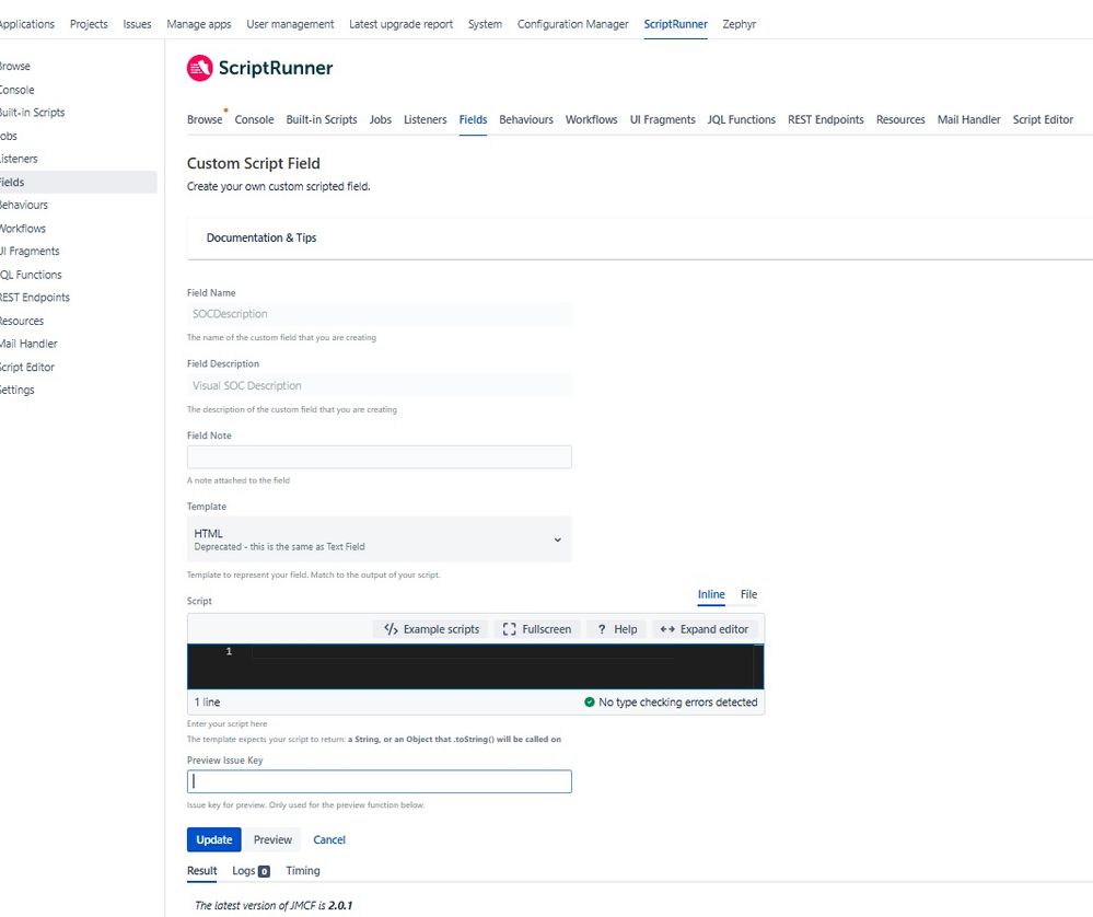

Already saw atlassian doesnt want to support HTML because of secuirty. I am fine with this.
But is it true that we can create Custom Scripted Field and make it HTML-friendly?
If yes...any hints what to provide in groovy line?
The goal here is...I have System Field Description in my tickets and they have RAW HTML many (span) tags. Want to keep it that way in Description field but replicate the content and put in custom field SOCDescription where HTML is supported. Is it do-able...?
Hello @Mateusz Janus
Yes, this is doable in ScriptRunner, but I wouldn't use the old HTML template for it.
Just to clarify: that Appfire page covers JMCF, not ScriptRunner. In current ScriptRunner for Jira Data Center, the HTML template is deprecated and behaves the same as Text Field. Adaptavist's current examples that render HTML use Text Field (multi-line) and build output with MarkupBuilder.
For a quick test, try a scripted field with Text Field (multi-line) and simply return:
If your Description already contains literal HTML, that will tell you quickly whether it renders as expected in your environment.
That said, I'd be cautious with re-outputting raw HTML from Description. Atlassian disables HTML rendering by default due to XSS risk, and Adaptavist's safer pattern is to build only the markup you actually need with MarkupBuilder rather than blindly re-outputting arbitrary HTML.
Also worth considering: if your real goal is a persistent mirrored field, a scripted field is probably the wrong tool. It's a calculated/display field that recalculates on reindex, not a stored value. For a real stored copy, you'd be better off with a normal custom field kept in sync via a ScriptRunner Listener or Job.
