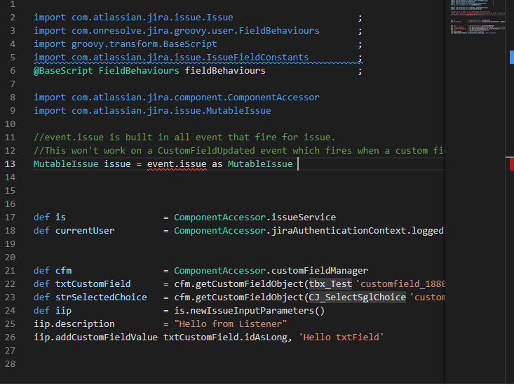

Hi everyone.
I built a Behavior that is working but am not having luck with Listener.
The listener does not seem to be firing.
I need it to fire on a field changed event.
I added the "Issue create" Event to see if I could get anything but am not having any luck.
This is my code for now.
I have stripped it code down for testing.  Just want to see the event fire.

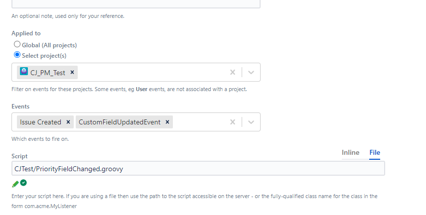

pic of my Listener setup is included.

Here is your example converted to use the correct methods:
import com.atlassian.jira.component.ComponentAccessor
import com.atlassian.jira.issue.MutableIssue
//event.issue is built in all event that fire for issue. This won't work on a CustomFieldUpdated event which fires when a custom field configuration is changed
MutableIssue issue = event.issue as MutableIssue
def cfm = ComponentAccessor.customFieldManager
def is = ComponentAccessor.issueService
def currentUser = ComponentAccessor.jiraAuthenticationContext.loggedInUser
def txtCustomField = cfm.getCustomFieldObject('customField_18801')
def iip = is.newIssueInputParameters()
iip.description = "Hello from Listener"
iip.addCustomFieldValue txtCustomField.idAsLong, 'Hello txtField'

CJ_Marchand
May 17, 2023
Thanks for the reply Peter.  Looking at code now but it looks like "event.issue" Is not recognized.
Am I missing an import statement?
Thanks,
cj
PD Sheehan
May 17, 2023
That's normal in an external IDE.
"event" is a variable that will be injected by scriptrunner during runtime.
If you use the scriptrunner in-line code editor, you will see that in there, event will not have any error.
To know what variables will be injected into a script in any context, click on the question mark below the script editor field.

I put the following code inline in the Listerner and it is saying that issue is not a property of "event".
Not getting any response from the Listerner.
Thanks,
cj
PD Sheehan
May 22, 2023
The event variable will dynamically be interpreted in the in-line code box depending on the Events selected in the form.
If you only have "Issue Created" in the form, the static type checking should identify it correctly.
But if you have more than 1 event selected, all events must be the same type and contain the same methods and properties.
In your case, remove the CustomFieldUpdatedEvent (if it's still there).

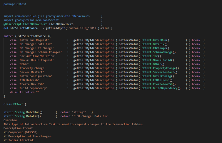

CJ_Marchand
May 24, 2023
Works fine!
Built a behaviour and added the selectSingleChoice field, then added code file.
Here is the code in case someone else may need to do the same.
A big thank you to Peter.  You saved me days of searching and testing.
PD Sheehan
May 24, 2023
You're welcome.
Maybe your longer experience would point to reasons why one is better than the other but wanted to share what pattern I would choose to reduce the verbosity of your code.
Something like this:
import com.onresolve.jira.groovy.user.FieldBehaviours
import groovy.transform.BaseScript
@BaseScript FieldBehaviours fieldBehaviours
def fieldMap = [
'Batch Run Request': EEText.batchRun,
'DB Change: Data Fix': EEText.dataFix,
'DB Change: RT Change': 'direct text instead of using a class'
def formField = getFieldById('customfield_xxxxx')
def targetDesc = fieldMap[formField.value]
if(targetDesc) getFieldById('description').setFormValue(targetDesc)
class EEText {
static String batchRun = '''all your text here'''
static String dataFix = '''another default description''
The main crux is using a map instead of a switch.
Also, if you set up your script root correctly per the instructions in the adaptivist documentation, you can save your EEText in a separate file (EEText.groovy) and just import it in your behaviour script.

May 17, 2023
Added pic of Listener setup.
