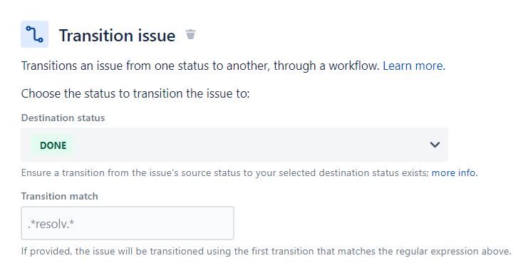

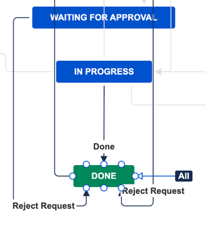

I have a workflow where I have two transitions into the Done status. One is to cancel the request and sets the resolution to cancelled (this one is available from all other statuses). The second one goes from In Progress to Done and gives you a resolution screen to set it yourself. I am trying to use automation to set the resolution for some projects using this workflow transitioning via the In Progress to Done, but when I select this in Automation for Jira, it chooses the transition that cancels the request.
How can I specify or differentiate between these two transitions? I see the transition ID of 101 for Done (and 31 for Cancel Request), but in the automation I don't know how to use the "Transition Match" feature. All the regex I have tried doesn't work.image.png

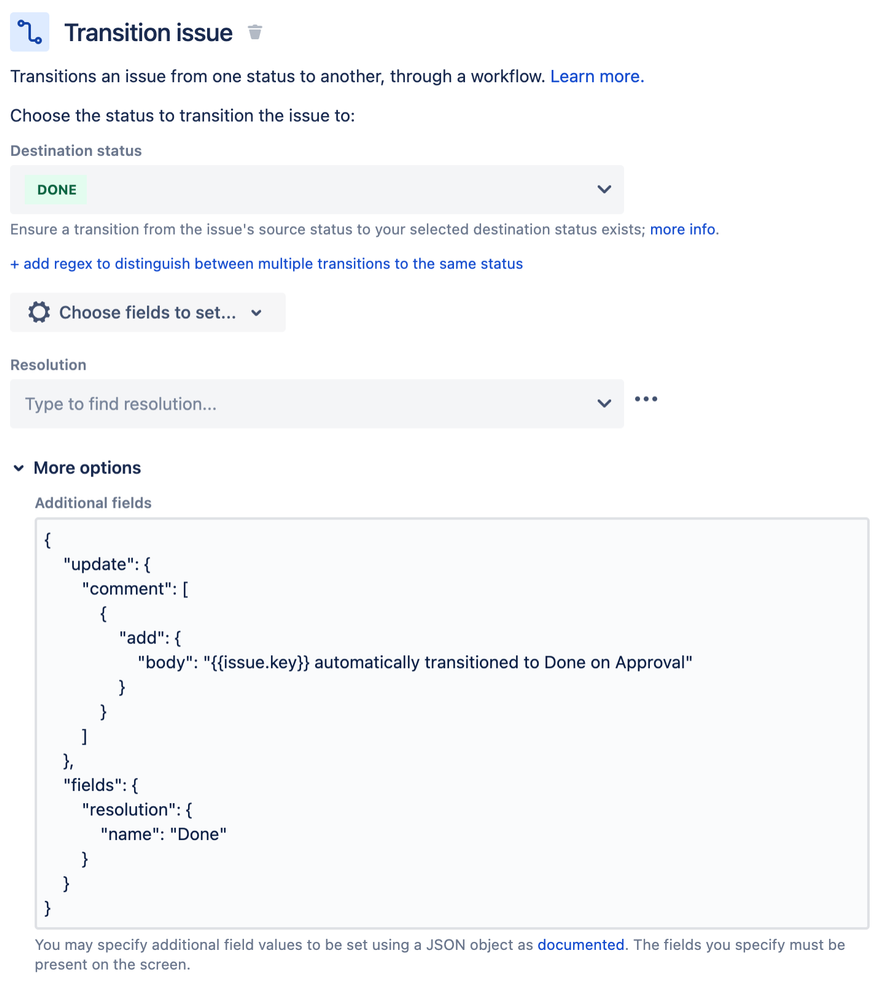

I have tried to bypass this by using the Cancel Request transition it insists on using but I can't set the Resolution because there is only a Comment field on the transition screen (I have managed to set a generic comment though). This results in the transition to Done but means the resolution is still Cancelled.image.png

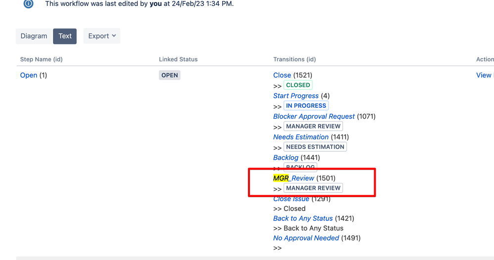

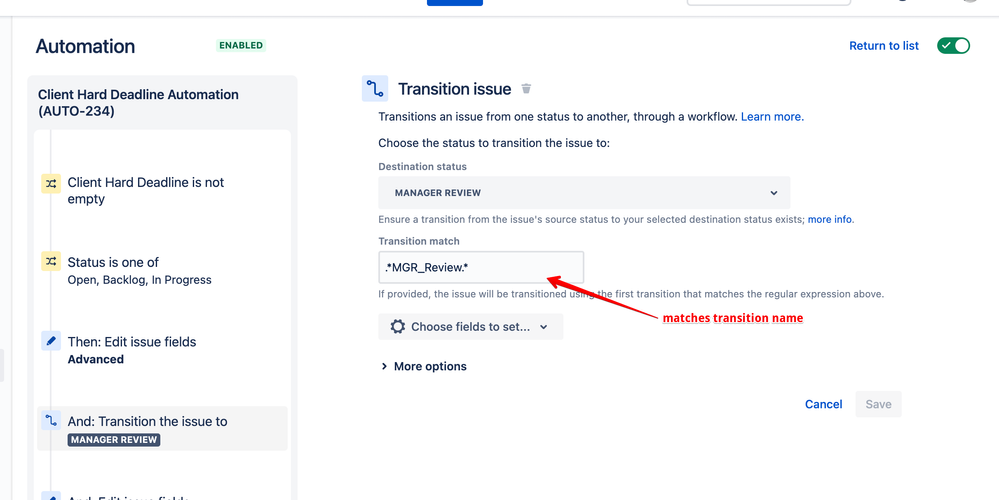

Jeffrey Bistrong
February 24, 2023
This worked for me, i just had to match the transition name exactly, i couldn't get it to work when the transition name had spaces in it, so replaced the space in the transition with an underscore, and now its working
Monosnap View workflow — DB_CR Workflow v1.2 - JIRA 2023-02-24 13-37-23.pngMonosnap Automation - Jira 2023-02-24 13-35-46.png

Hi @Steven Rhodes
Under where you have set the Done status, there is an option to "+ add regex to distinguish between multiple transitions to the same status ".
Here, you can enter some regex based on the individual transition's name in order for the correct transition to be used.
Either this, or you can just add a post function on the specific transition to set the Resolution, meaning you don't have to 'edit' the resolution field, nor do you have to have the resolution on the transition screen (this may be the easiest solution).

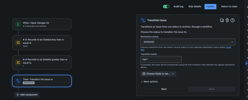

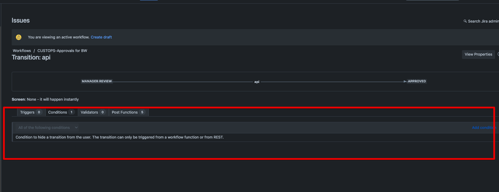

Jeffrey Bistrong
June 4, 2024
I got this error a lot turns out the workflow conditions i put in place were blocking it. So i made a new transition just for the automation with no conditions on it except for this one and I was able to resolve my issue.Monosnap Transition_ api - JIRA 2024-06-04 23-21-42.png
This is what my automation looks like
