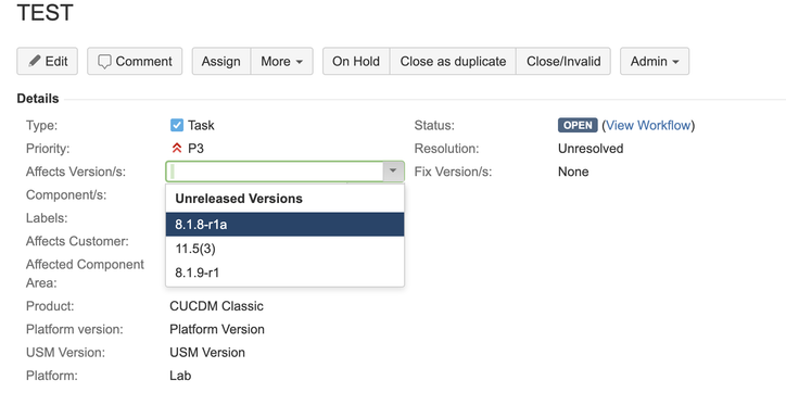

Thank you so much for your quick response. I truly appreciate it... However the dropdowns are still showing all the options and not the ones specified as per above.
Below is the screenshot of the actual result:

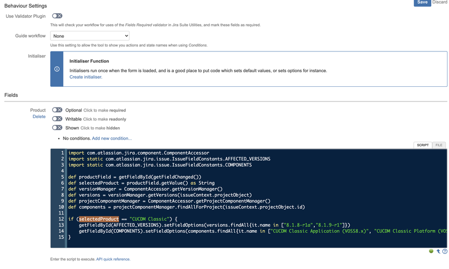

image.pngAnd below is the configuration of the behaviour:
image.pngSome more of your assistance on this would be greatly appreciated

That is expected behavior. Scriptrunner behaviours are only effective in full edit screen. They can't work for in-line edits.
To get around that, you have to disable inline edits for those fields. Then, when the user attempts inline edit, the edit screen will pop up.
To disable those inline edits, just add those 2 fields to your behaviour configuration (just like you did for Product, but you don't need to change anything else. No serverside script, no read/hide attributes)
Kurt October October 18, 2020
This works... Thank you so so so so so much!!!!
