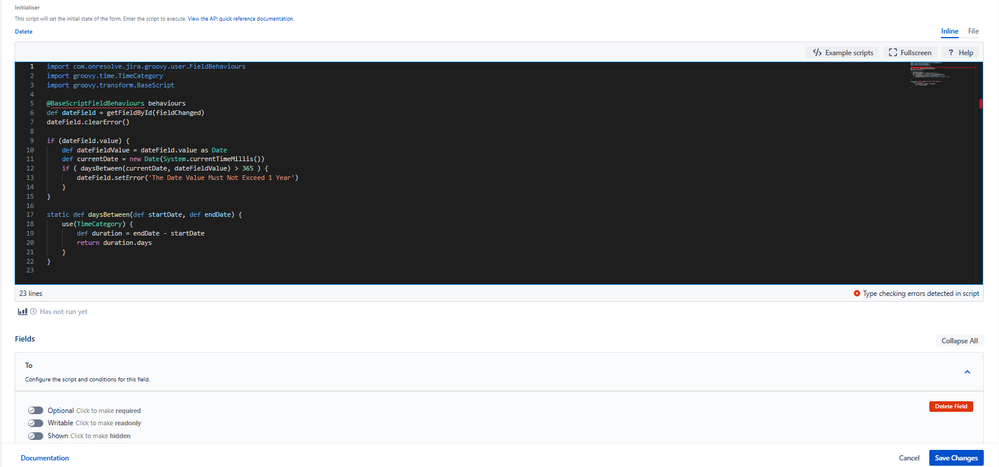

For your requirement, you must create a Server-Side Behaviour for the Date field you intend to validate.
Below is a sample working code for your reference:-
import com.onresolve.jira.groovy.user.FieldBehaviours
import groovy.time.TimeCategory
import groovy.transform.BaseScript
@BaseScript FieldBehaviours behaviours
def dateField = getFieldById(fieldChanged)
dateField.clearError()
if (dateField.value) {
def dateFieldValue = dateField.value as Date
def currentDate = new Date(System.currentTimeMillis())
if ( daysBetween(currentDate, dateFieldValue) > 365 ) {
dateField.setError('The Date Value Must Not Exceed 1 Year')
static def daysBetween(def startDate, def endDate) {
use(TimeCategory) {
def duration = endDate - startDate
return duration.days
Please note that the sample working code above is not 100% exact to your environment. Hence, you must make the required modifications.
Below is a screenshot of the Behaviour configuration:-
Please note, in the screenshot above, the editor is showing a few red lines. These are not coding errors, but are static type checks. In other words, the code works and is able to return the expected result.
I hope this helps to answer your question. :)

Hi @Ram Kumar Aravindakshan _Adaptavist_ ,
Thanks for the provided example, I set it and mapped it with my field, but still it allows me to open a ticket, while setting it to a greater date than a year.

Gor Greyan
May 19, 2025
Gor Greyan
May 19, 2025
Dear @Ram Kumar Aravindakshan _Adaptavist_ ,
The result is that it allows me to create the ticket, despite the fact that I choose the date, for example, 2030.
I mapped it with my field which is To field.
May 20, 2025
Hi @Gor Greyan
The code is not working because there is an error in the Annotation used.
I noticed that the code that I had pasted in my previous comment was displaying the annotation incorrectly. I have corrected it.
Please modify the annotation in your code from:-
@BaseScriptFieldBehaviours behaviours
to:-
and rerun the test.
Thank you and Kind regards,
Ram
Gor Greyan
May 20, 2025
Thanks a lot, it works.
