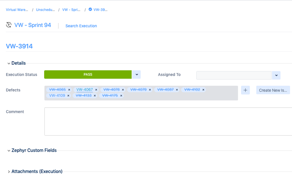

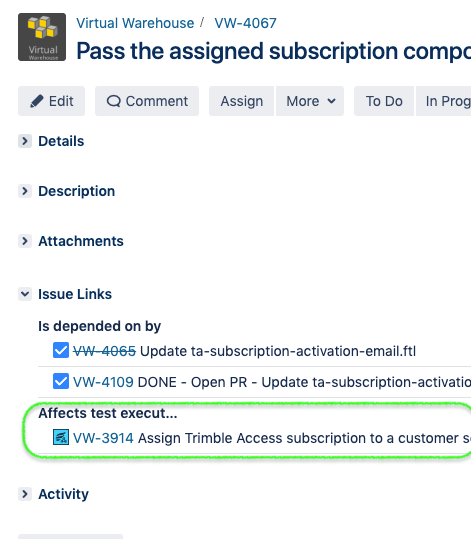

Hi there, I think I'm trying to query our cloud Jira v8.13.0 in similar way to find out which issues (in TEST column on our Jira board) are not associated with the test execution).
Querying Issues by issueLinkType doesn't work, as the "Affected test execution of..." issue link type is not a standard issue link type which means you cannot link the Test ticket to it from the issue itself.
The only way how to add that link is goto the Test Cycle, find the Test ticket (Zephyr for Jira), and either enter it into the defects fields or additionally in the new (or existing) Execution, and after that i is done you can finally see the test ticket to be linked under the work issue.

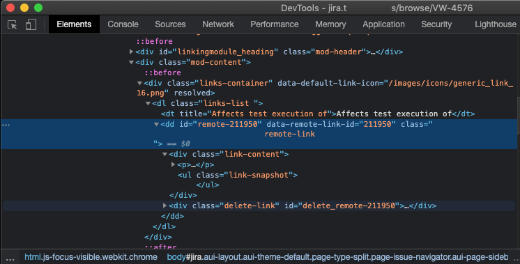

The last thing I can share is how that appears as the rendered source-code:
Any help would be highly appreciated including some howto use JS console to query Jira directly.
