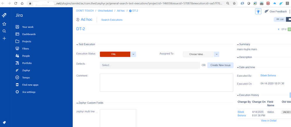

@Vasu_Repaka ,
You should pick any execution on your instance and go to the execution page. There you should be able to get the IDs in the URL. I am just adding a sample from my setup.

@Vasu_Repaka ,
With out using the ZAPIs it would not be possible as the execution details are plugin specific, which can't be assessed via JIRA's native methods.
