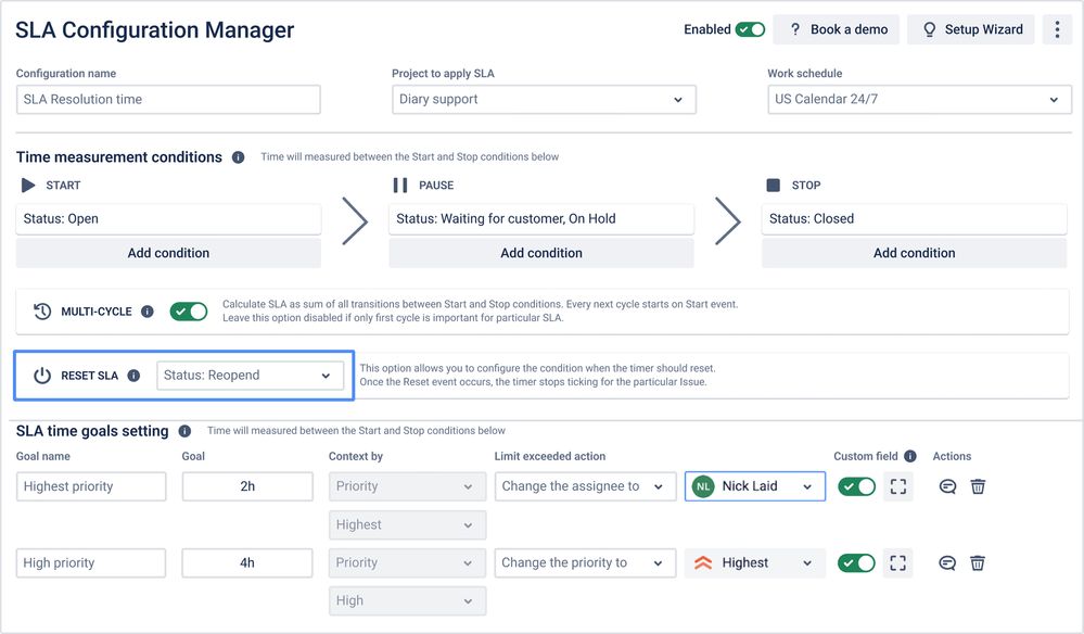

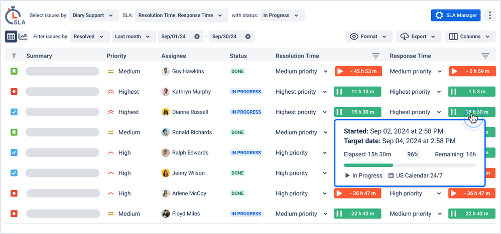

💡 Pro tip: Identifying the exact reason why an SLA didn’t stop can be incredibly time-consuming, especially when you're combing through workflows, custom statuses, and issue histories manually. That’s where SLA Time and Report for Jira becomes your trusted helper.
With this app, you can instantly visualize each SLA cycle, see exactly when the timer started, paused, or should have stopped, and spot misfires in seconds. Even better, it offers a built-in “Reset SLA” feature, allowing you to quickly correct SLA behavior on affected issues without touching the workflow or writing complex automation rules.

With SLA Time and Report, you just:
Even better? You can filter and batch fix similar issues across your queue, using visual indicators and SLA filters like:
