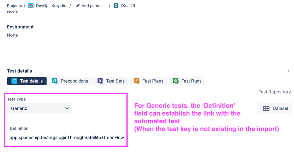

  • For tests labeled as 'Generic,' they'll get matched up using the generic definition field in Xray.

Alternatively, here is how Xray can link to the coded test via the class name:
