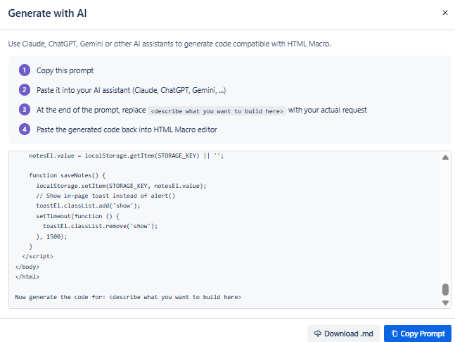

If you're using HTML Macro specifically, this same prompt structure is already built in: the macro editor has a "Generate with AI" option that produces a ready-to-copy version of this prompt for you.

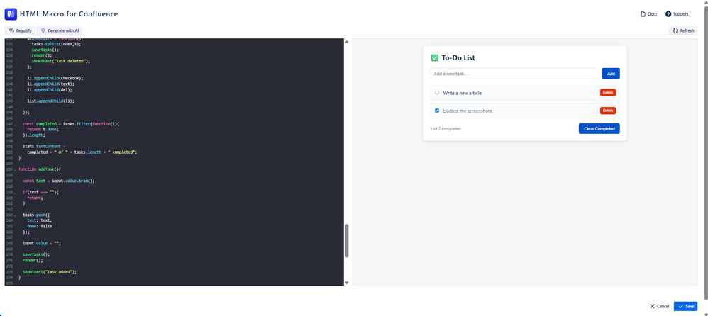

Here's what that looks like in practice: a simple to-do list, generated this way, pasted into the editor with the live preview updating automatically.

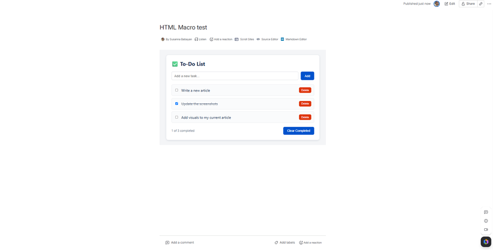

And the same widget once published, fully interactive on the live page.
