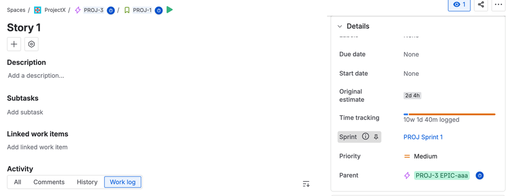

1️⃣ How time tracking works in Jira
Every issue in Jira — task, bug, story, ticket — can store:
  • Original estimate (what we planned)
  • Time spent (what actually happened)
  • Remaining time (what’s still outstanding)
[Screenshot: Jira issue with estimate + time spent fields visible]
This gives you a simple but powerful truth:
work and time live together — in one place.
Whether you’re tracking client work or tracking internal initiatives, the mechanics are the same.

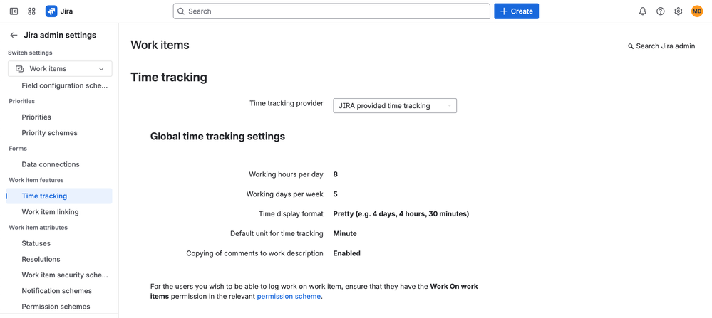

2️⃣ Enable time tracking in Jira (quick setup)
Go to:
⚙️ Settings → Work Items → Time tracking → Enable
Then check:
  • hours per day (e.g., 8)
  • days per week (e.g., 5)
These settings affect reports, so it’s worth getting them right before you start.

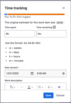

3️⃣ Logging time on work items/issues (your daily routine)
Open an issue → click Log time.
Add:
  • Time Spent
  • Date
  • short description like
    “Planning meeting with design”
    “Investigated production bug”
Tip:
log daily — memory fades fast, data accuracy drops.

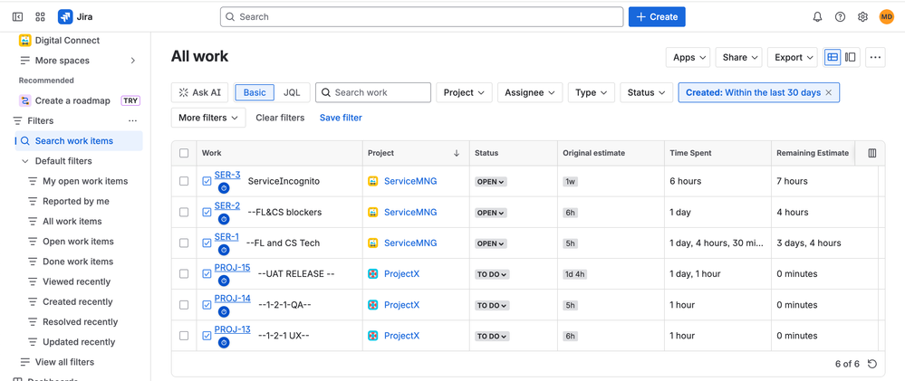

📊 Option 1: Issue Navigator + Time Columns
Go to:
Filters → View all Filters
Then add columns such as:
  • Time Spent
  • Original Estimate
  • Remaining Estimate
You can also filter by project, sprint, assignee, label, etc.
This works well when you want detail, like:
  • “How long did each bug take?”
  • “Which tasks consumed the most time?”
You can export to CSV if needed.

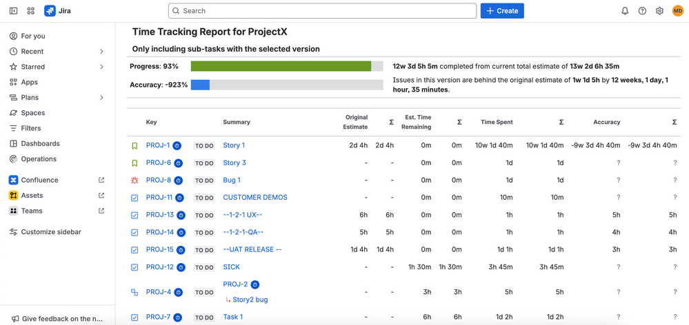

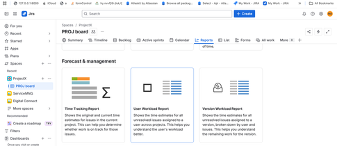

📈 Option 2: Worklog Reports (Jira Software)
If you’re using Jira Software, there is a native Time Tracking Report.
Go to:
Reports → Time Tracking Report
You will see the report  only if ALL of these are true:
✔ You’re on Jira Software (Cloud or Data Center) — not Jira Work Management
✔ The project is company-managed (formerly “classic”), not team-managed
✔ Time tracking is enabled in settings

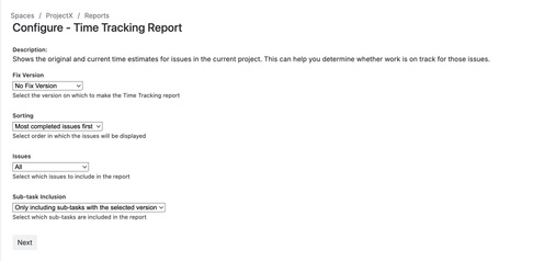

Open the Time Tracking Report and configure it:
Then you will see this time report:
It’s simple — but surprisingly helpful for versions time spent retros.

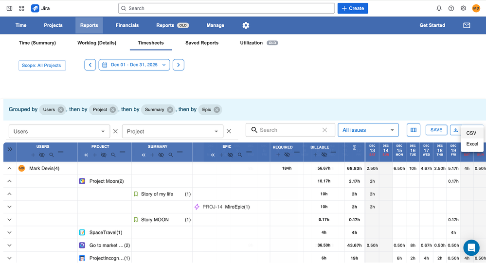

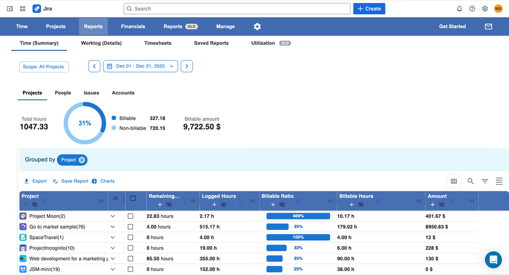

7️⃣ Adding Timesheets on top of Jira (the missing layer)

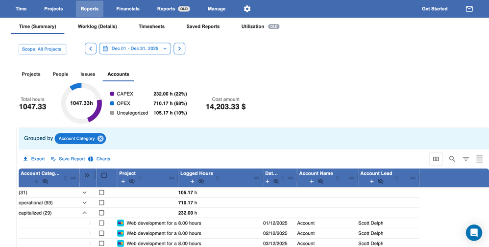

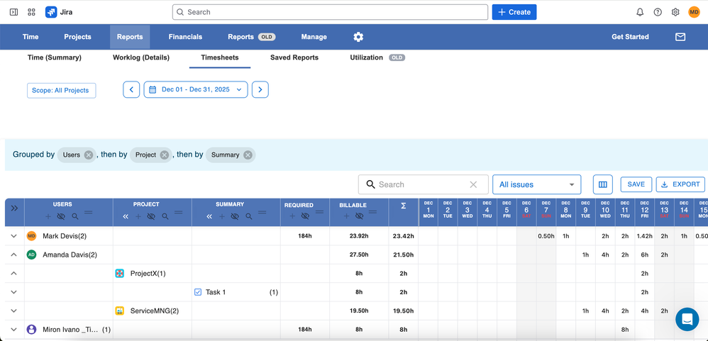

Think of timesheets as:
“a clearer, more organized lens over everything people already log.”
They don’t replace Jira.
They simply take all those scattered worklogs and turn them into something understandable:
  • weekly / monthly calendars
  • totals by user / project / team
  • cost center breakdowns
  • approvals
  • exports
  • financial insights if needed

Worklog360 gives:
✔ clean weekly and monthly timesheets
✔ grouping by project, team, assignee, epic, etc.
✔ filters that make sense (no guesswork)
✔ easy export when you need to share data
You don’t need to turn on billing, budgets, or anything financial if you don’t want to.
It works great simply as a clarity layer.

Worklog360 allows you to:
✔ define cost centers  (accounts in Worklog360)
✔ track effort per department(accounts)
✔ create internal budgets
✔ see trends over time (in progress)
This isn’t about billing anyone — it’s about better planning and accountability.
⭐ 3) For teams working with clients (billable projects)
If you bill customers, your questions change:
  • Are we staying profitable?
  • How much should we invoice?
  • Are we burning budget too fast?
  • What part of the work isn’t billable?
Worklog360 supports that layer when you need it:
✔ billable vs non-billable
✔ per-project / per-user / per-role rates
✔ project budgets & alerts
✔ profitability insights
✔ invoicing from worklogs (when you want it)
