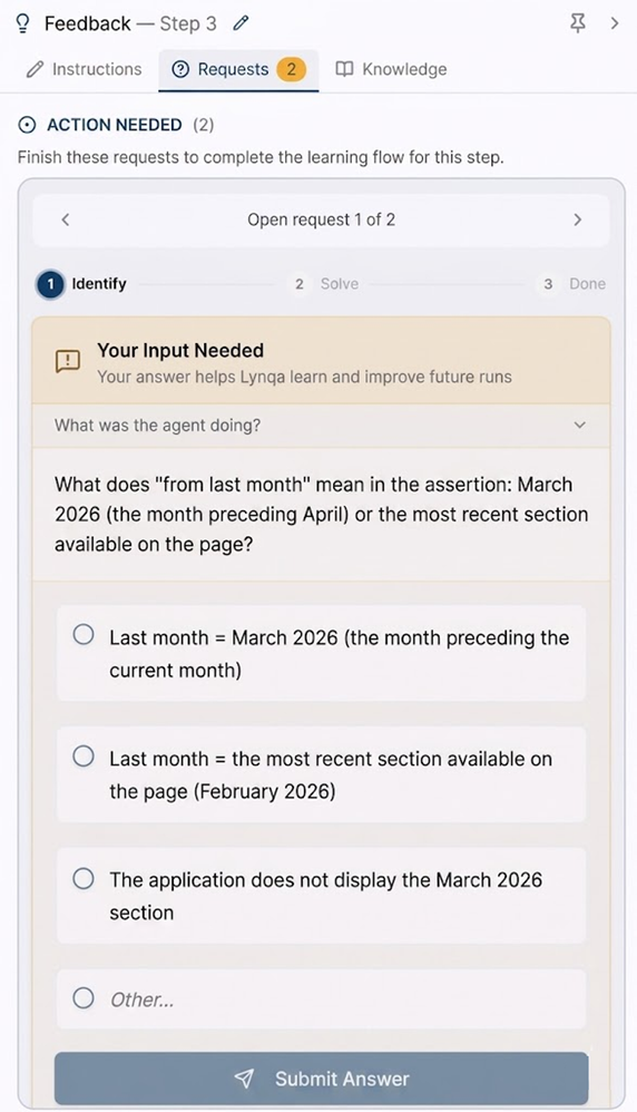

A concrete example
A test case checks a website section called “Most read articles.” One step asks the agent to verify the “most read articles from last month.”
The test runs in early April 2026. On the website, however, the most recent monthly section available is February 2026.
So what does “last month” mean here? March 2026, the calendar month before April? Or the most recent monthly section actually available on the page?
This is the kind of ambiguity a human tester would notice, and a good AI test execution agent should too.
The agent raises a clarification request. The QA tester answers: “Last month = the most recent section available on the page.”
Lynqa raises a clarification request when a test instruction is ambiguous, and stores the answer as reusable knowledge.
From that answer, the agent creates reusable knowledge:
“When checking content corresponding to ‘last month,’ use the most recent month actually available on the page, not necessarily the calendar month before the current date.”

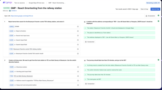

Screenshots play an essential role: they document actions and observed states and make human review fast.
A Lynqa for Xray execution report: per-step actions on the left, expected results with observed evidence on the right, screenshots and verdicts attached.
