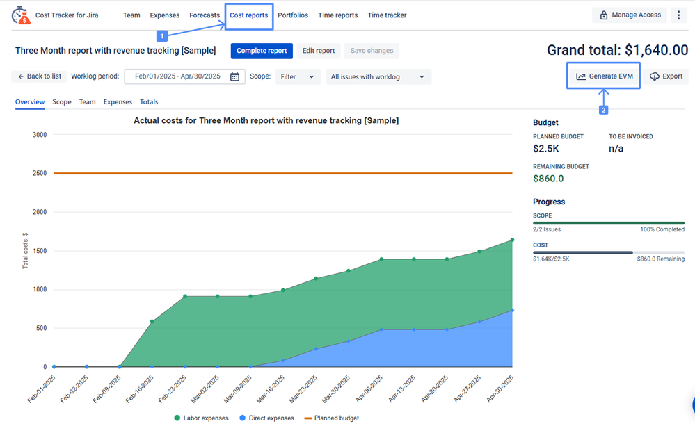

How to generate EVM reports in Jira with Time & Cost Tracker
With Time & Cost Tracker, project managers can create cost reports and export them into an EVM Excel template for in-depth analysis.
Step 1  — Install the app.
Step 2  — Log work hours and expenses for accurate data.
Step 3 — Generate a Cost Report
  • Navigate to the Cost Reports tab.
  • Click Generate EVM.
Step 3 — Open the downloaded file to analyze the EVM report.
