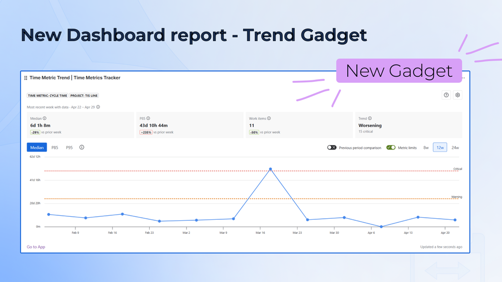

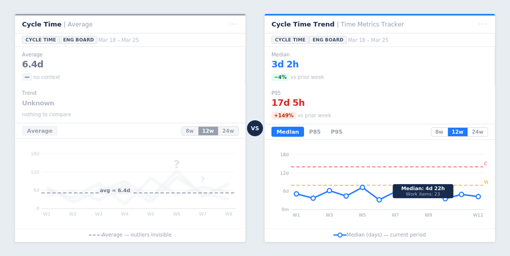

Why the Trend Chart Is a Game-Changer
  1. It shows when delivery starts drifting: You can spot exactly when the process started changing—whether the Median is slowly creeping up or the P85 is widening week by week.
  2. It makes variability visible: Two teams can have the same Median Cycle Time but behave differently. P85 and P95 reveal if one team is actually struggling with a "long tail" of delayed work.
  3. Evidence over Emotion: Instead of saying "delivery feels slower," teams can point to the P85 moving from 6 to 10 days. This makes retrospectives specific and actionable.
  4. Connects Planning with Reality: P85 helps set realistic expectations, while P95 explains the edge cases and risks that might affect a release or SLA.
  5. Jira Dashboard Utility: It turns a status board into a delivery health monitor.
See These Trends Directly in Jira
To track these signals without exporting data to spreadsheets, you can use the Time Metric Trend Gadget in Time Metrics Tracker | Time Between Statuses.
It allows you to monitor Cycle Time, Code Review time, or QA time directly on your Jira dashboard with:
  • Median, P85, and P95 trends to see how work distribution changes.
  • Comparison features to check the current period against the previous one.
  • Drill-down capabilities: Click any point on the chart to see the exact issues causing a spike.
  • Warning/Critical lines to alert you when delivery crosses specific thresholds.
