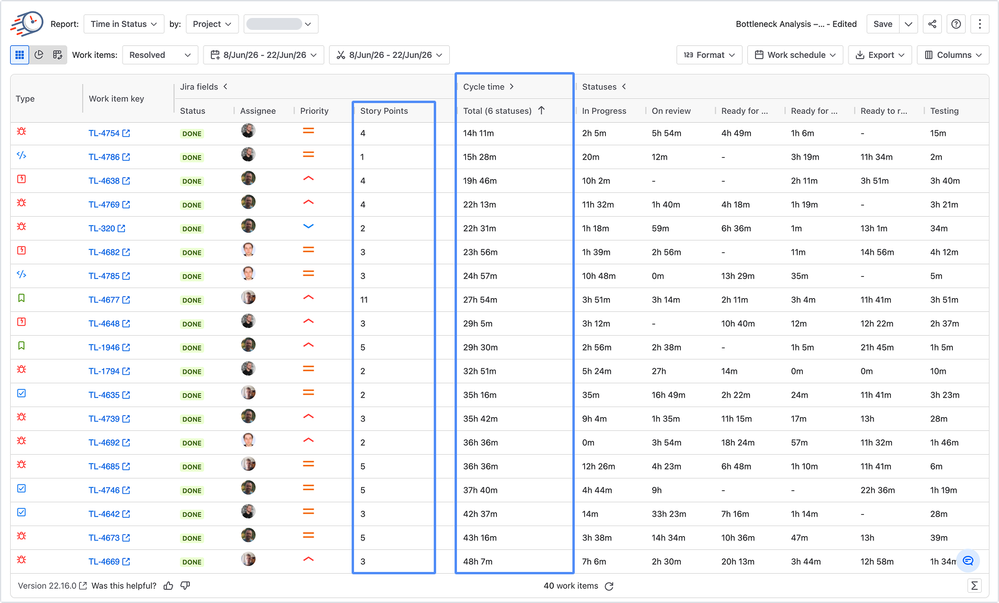

This type of analysis becomes much easier when Jira history is turned into time-based reporting.
In Time in Status by SaaSJet, teams can use reports such as Average Time and Time in Status to understand how long issues actually spend in different workflow stages. When those reports are grouped or pivoted by story point value, the team can compare estimates against real cycle time.
A useful setup could look like this:
  • filter completed issues from the last several sprints
  • group by story point value
  • calculate average cycle time
  • compare results across issue types, assignees, projects, or sprints
  • look for point values with unusually high variance

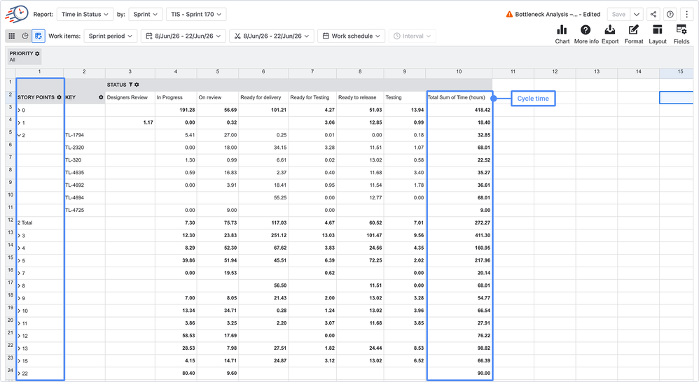

This is where Pivot Table View or row grouping becomes especially useful. Instead of scanning issue by issue, the team can compare story point values across groups and see whether the data support the assumptions behind the estimates.
