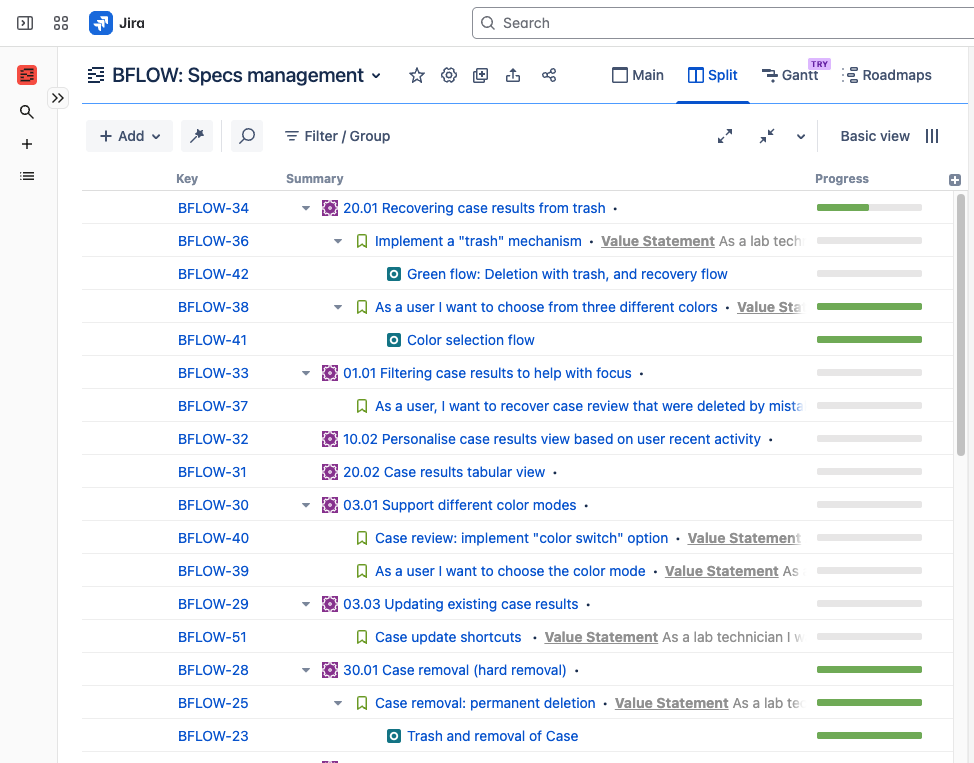

Using Structure to visualize a tree in Jira, whatever links and relations you are interested in
Think of Structure as a way to organize all your Jira work items—requirements, stories, tests, and even defects—into a neat, customizable hierarchy. Instead of scrolling through endless lists, you get a visual, tree-like view of how everything connects. For example, you can see requirements at the top, linked to user stories beneath them, which in turn are linked to tests. This helps you, as a product manager or version manager, instantly spot what’s connected and what’s missing.

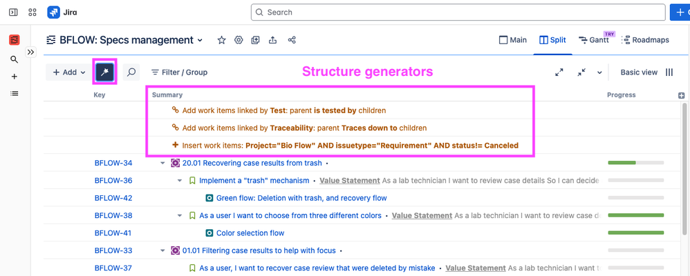

To define this Structure, you’ll use Structure “generators.” Generators are rules or configurations that automatically include and organize Jira issues in the Structure based on specific criteria, so you don’t have to manually add each item.
In my example, I am using three generators:
  1. The generator that brings into structure the requirements
  2. Then two generators that extend the structure to include stories traced down from each requirement, and tests linked from the stories.

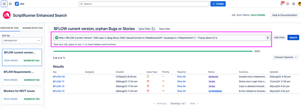

Next, in ScriptRunner Enhanced Search, define a filter that:
  1. Are part of our current filter AND
  2. Are bugs or stories AND
  3. Excludes those not traced down from requirements (this JQL is only available in Enhanced Search)
filter="BFLOW Current Version" AND type in (Bug,Story) AND !(issueFunction in linkedIssuesOf(" issuetype in ("Requirement")", "Traces down to"))
Ensure your Enhanced Query syncs regularly (ask your administrator to set this up).

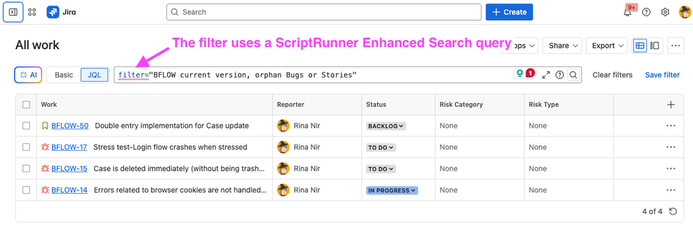

You can now access this Query through JQL by using the 'filter' keyword.

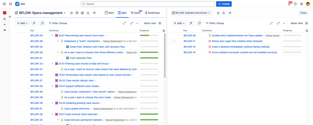

You can even configure Structure to highlight “orphans”—stories that aren’t linked to any requirements. If someone creates a story out of the blue, it pops up in this view, so nothing falls through the cracks. And fixing these issues is easy: just drag and drop an orphaned story to link it to the right requirement. Structure handles the background linking automatically.

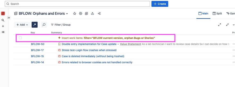

To set this up, define a Structure that has the filter we defined (using ScriptRunner Enhanced Search) as its generator
Structure and ScriptRunner Enhanced JQL together give real-time Jira visibility and control. You can view and fix SDLC issues quickly, keeping everything organized without switching toolsStructure generators orphans.jpg
