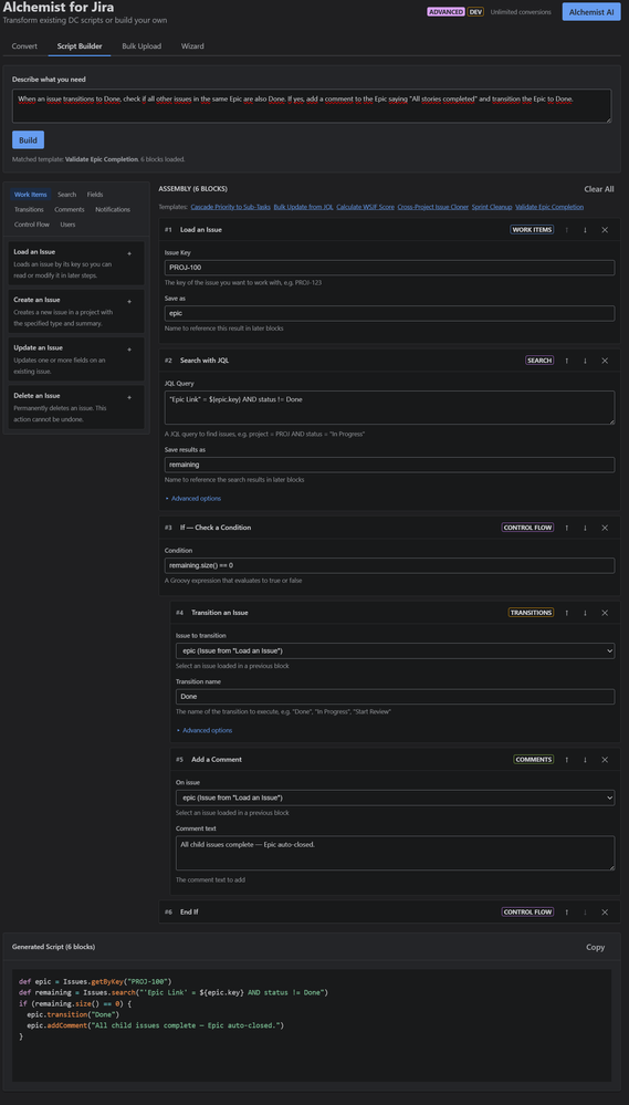

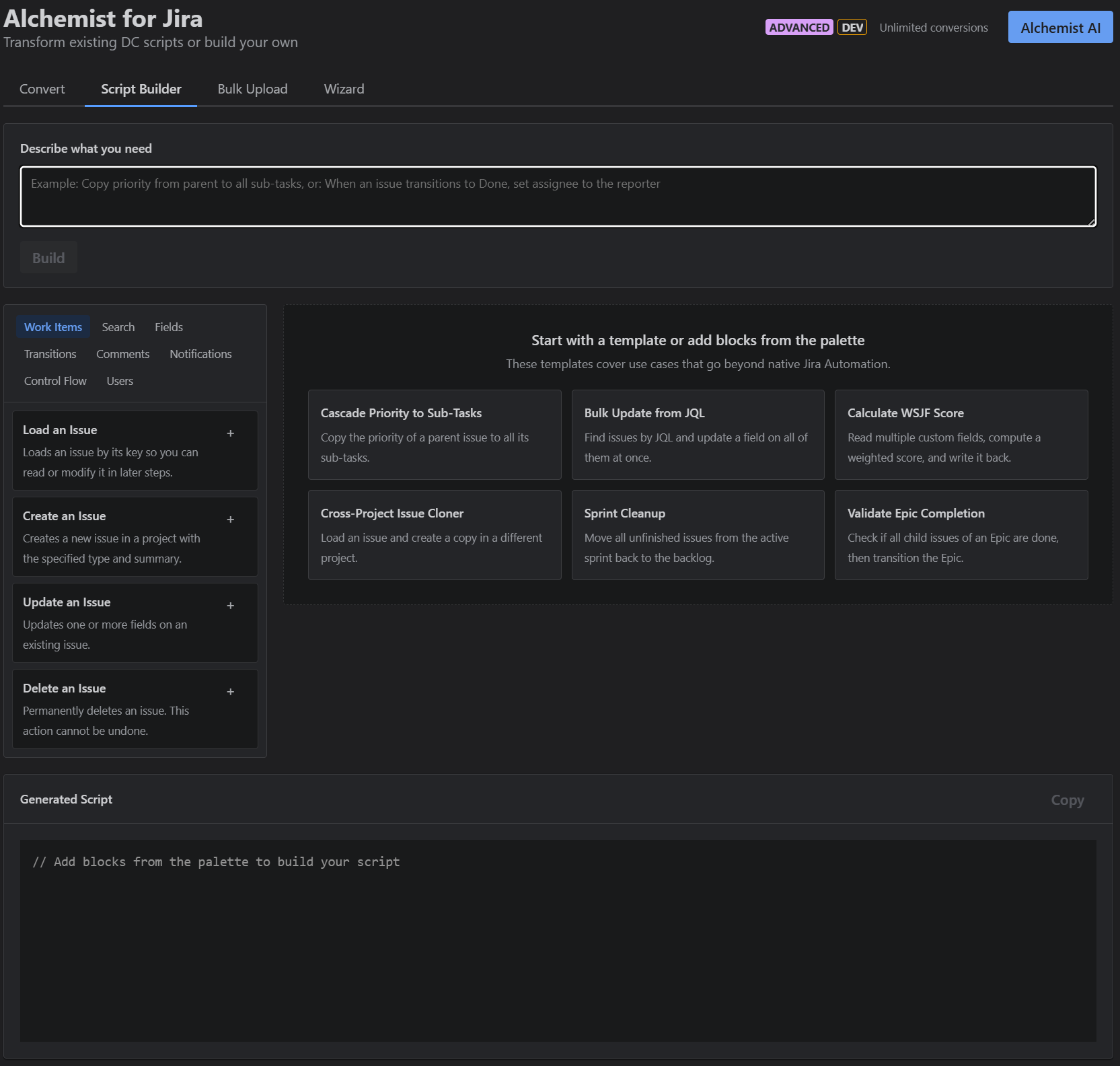

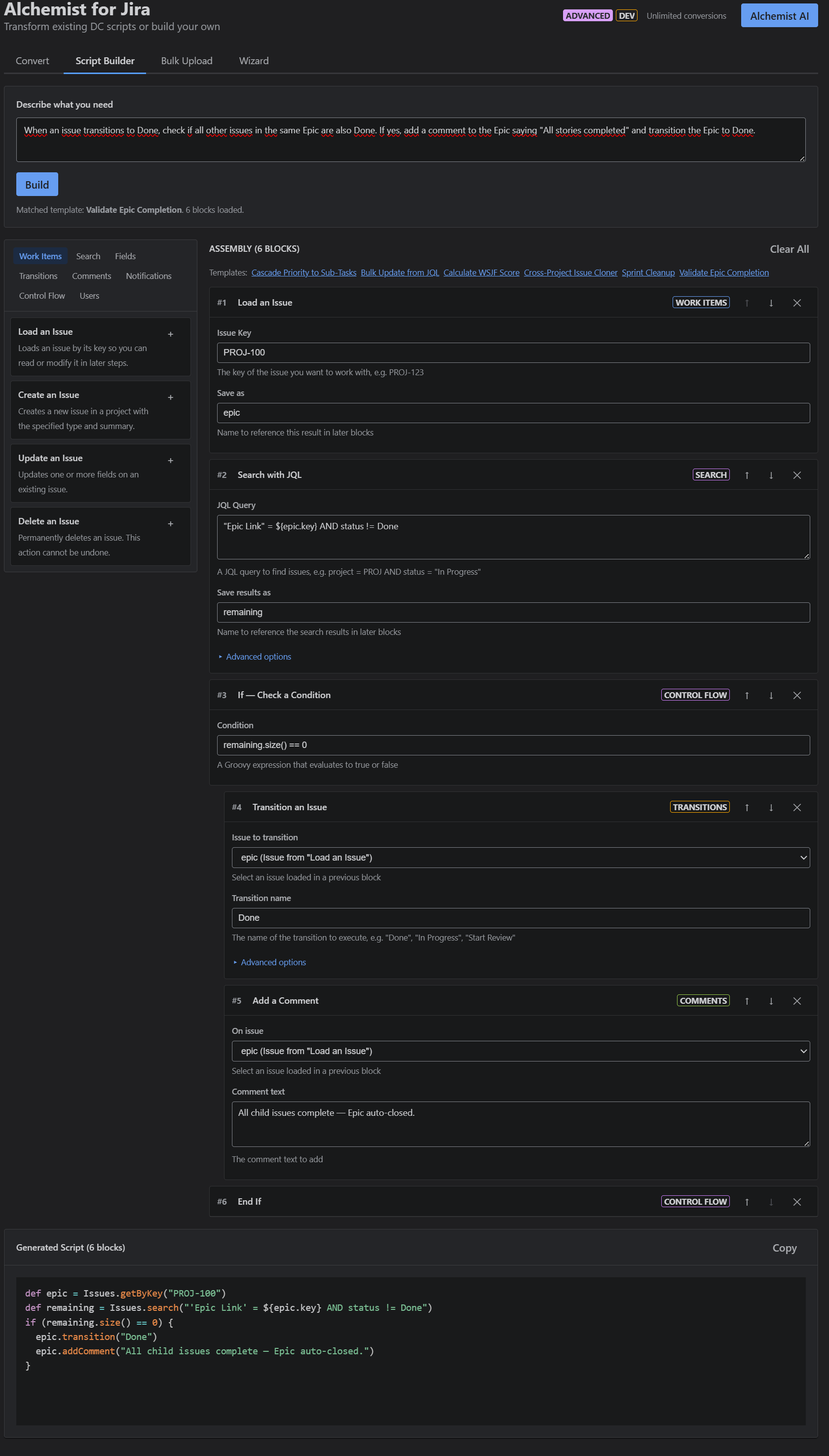

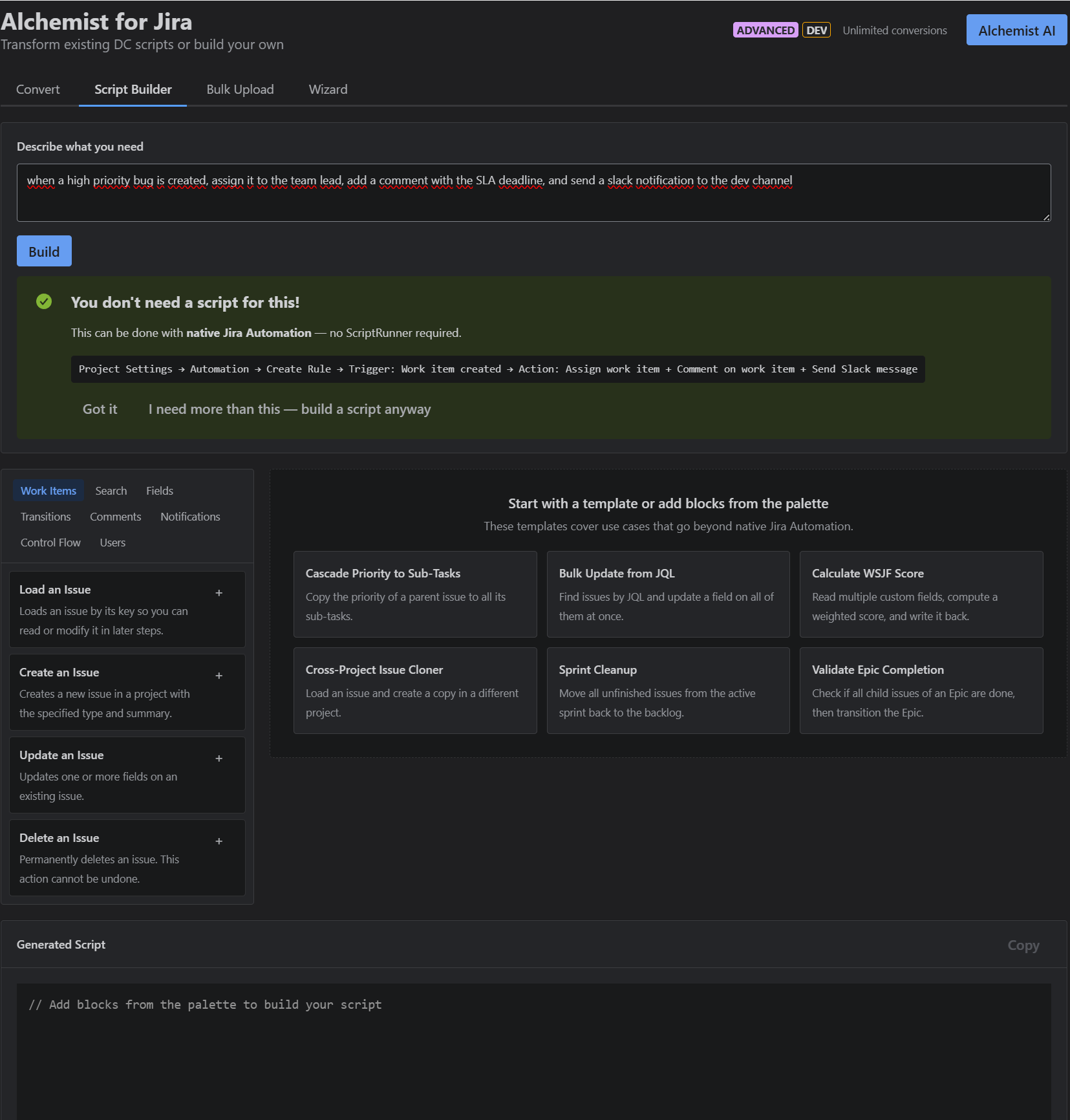

It's a visual drag-and-drop interface with 26 blocks across 8 categories: Work Items, Search, Fields, Transitions, Comments, Notifications, Control Flow, and Users. You assemble a script by stacking blocks. Each block maps to a HAPI operation. As you build, you see a live code preview: the actual Groovy that will run in ScriptRunner Cloud.
There are 6 pre-built templates for common workflows: Cascade Priority to Sub-Tasks, Bulk Field Update, WSJF Score Calculation, Cross-Project Clone, Sprint Cleanup, and Epic Completion Check. One click loads the full block assembly with the generated script.
Or you skip the blocks entirely and just type what you need in plain text: "Calculate the WSJF score from linked issues." Alchemist figures out the blocks and generates the code.
The Script Builder ships with Standard edition. No Advanced license needed.

When you describe what you need in the Script Builder, Alchemist doesn't immediately fire up an AI model. It runs your request through a three-stage routing pipeline:

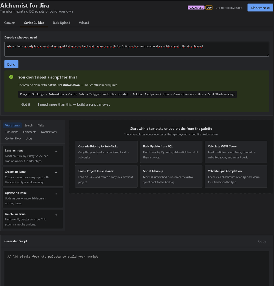

Stage 1: Native Automation Detection. Alchemist checks whether your use case can be solved with Jira's built-in Automation engine. "Send an email when an issue moves to Done"? You don't need ScriptRunner for that. Alchemist tells you so, shows you the exact path in Jira settings, and lets you decide whether to proceed with a script anyway. It recognizes common patterns (status transitions, email notifications, auto-assignment, sub-task operations, field updates, comments) including synonyms like "ticket," "task," or "moves to."
Stage 2: Template Matching. If native automation isn't enough, Alchemist checks against its template library and block patterns. Many requests match existing workflows and can be assembled without AI.

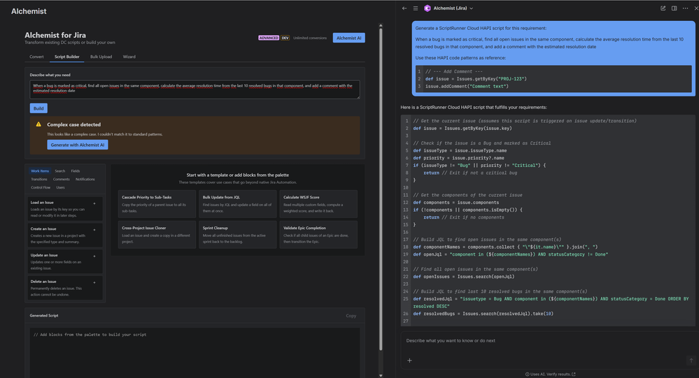

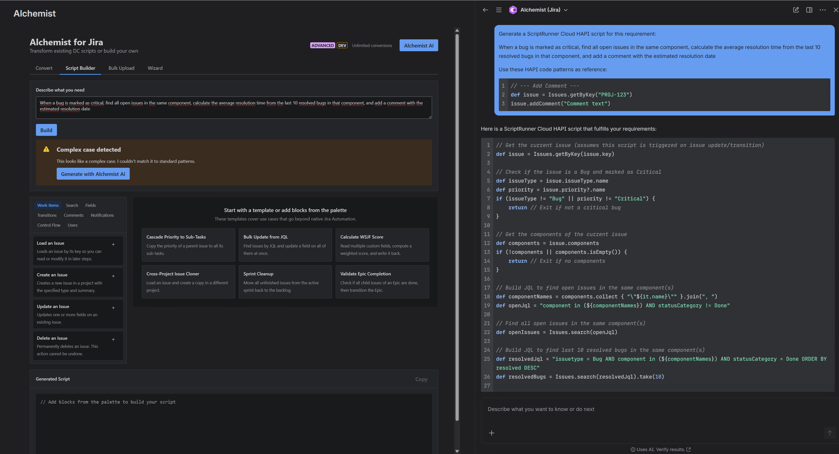

Stage 3: Alchemist AI. Only when patterns and templates can't handle the request does Alchemist escalate to its Rovo-powered AI agent for complex script generation. This is the Advanced edition feature, covering conversational migration assistance and script generation for edge cases.
Why does this matter? Because the most useful thing a scripting tool can do is tell you when you don't need a script. Every unnecessary script is future maintenance debt. Native Jira Automation is supported, documented, and maintained by Atlassian. If it can do the job, it should.
