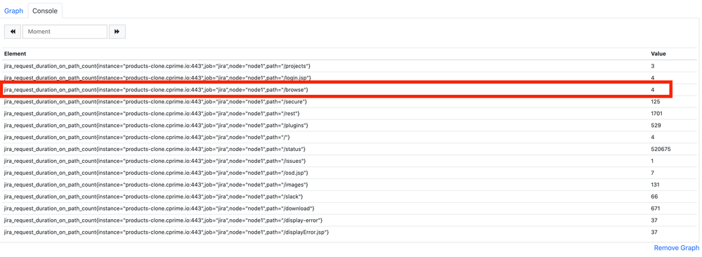

  1. jira_request_duration_on_path_count - contains the number of times the event happened. Here is an example:
Let's take the browse path. We can see that the browse path was requested 4 times.

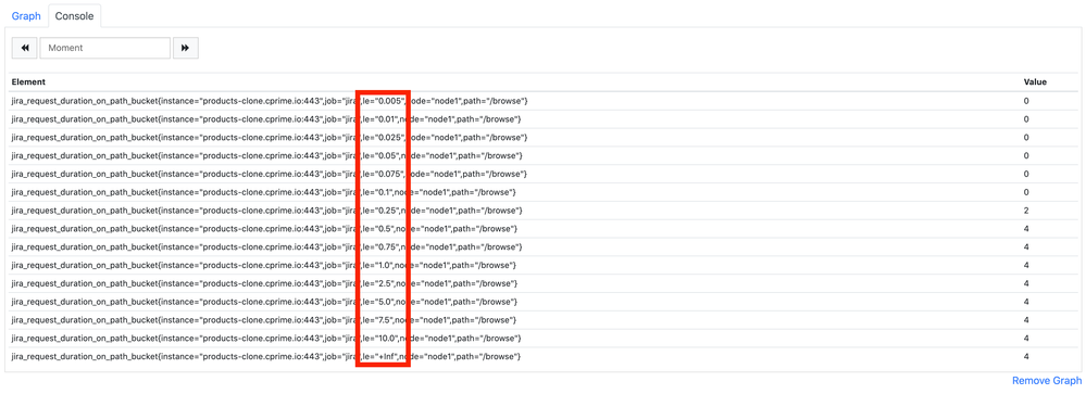

3. jira_request_duration_on_path_bucket - shows buckets for the metric.
Here is an example:
This image has an empty alt attribute; its file name is Screenshot-2020-10-12-at-19.02.05-1024x372.png
The "le" label means "less than the number of seconds" and it shows how many requests had duration less than the specified amount of time. For example, 0 requests were executed for less than 0.005 seconds. But 2 requests were executed for less than 0.25 seconds and 4 requests were executed for less than 0.5 seconds (those 4 requests include the two requests which were executed for less than 0.25 seconds).
As you can see there have been only 4 requests and jira_request_duration_on_path_count also confirms it.
