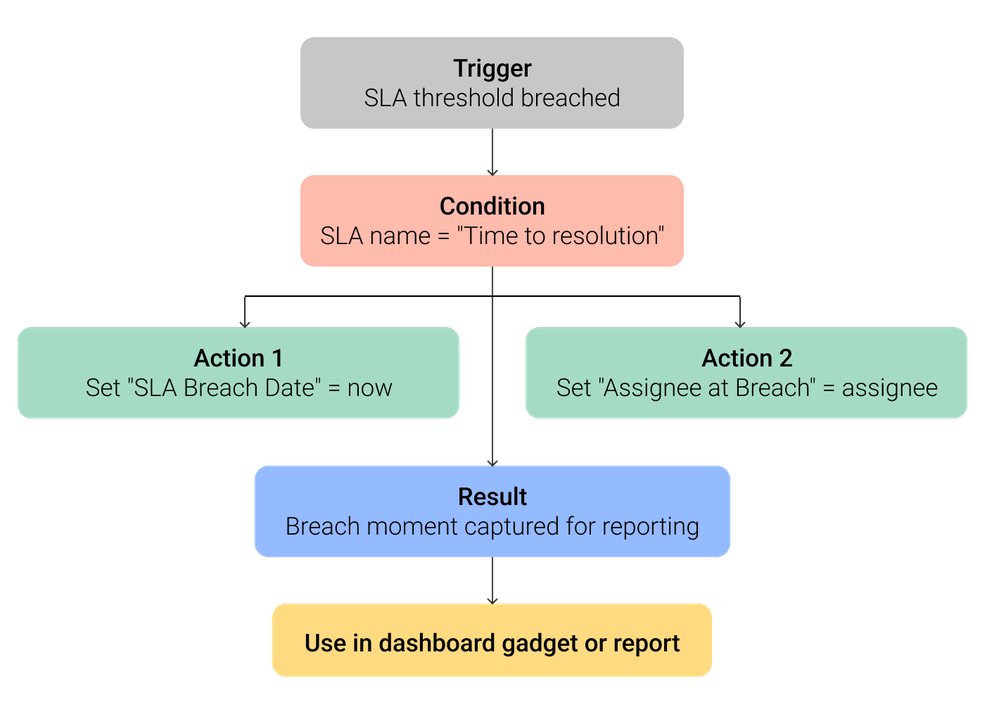

Step 2. Record the breach moment with automation
The second problem is timing. Without a dedicated field, you have no reliable record of when a ticket crossed the line. That makes month-end analysis and root-cause reviews much harder.
Jira automation solves this cleanly. Here's the setup:
Create two custom fields:
  • SLA Breach Date – Date Time Picker
  • Assignee at Breach – User Picker field
Build the automation rule:
  • Trigger: SLA threshold breached
  • Condition: SLA name = "Time to resolution" (or whichever SLA you're tracking)
  • Action 1: Edit work item → set SLA Breach Date = {{now}}
  • Action 2: Edit work item → set Assignee at Breach = assignee smart value
For the User Picker field, use the assignee's account ID smart value in the automation action. This makes the field easier to reuse later in reporting and filtering – User Picker fields in Jira work with account IDs rather than display names.
Once this is running, every breach is stamped – regardless of whether the ticket is ever resolved. Now your reports can be built on the actual breach moment, not on how the SLA happens to appear in a later chart view.

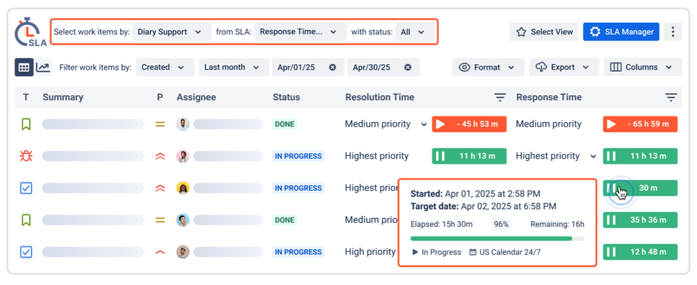

SLA Grid – your operational view
The SLA Grid is the most direct way to see every ticket's SLA status in one place. It displays each work item with its SLA timer, time remaining until the goal is exceeded, elapsed time, assignee, and current status – all in a sortable, filterable table. Tickets already in breach show in red; those still within target stay green. You can customize and reorder columns to match your workflow, and sort by any dimension: key, type, assignee, or SLA timer value.
This is the view agents and team leads should have open during the day – not a chart, not a percentage, but a live list of what needs attention sorted by urgency. When the team lead asks "what are we behind on right now," the Grid answers that question directly, without any manual filtering or exports.
The Grid also supports export to XLSX, CSV, PDF, PNG, JPEG, and SVG, so sharing a snapshot in a review or attaching it to a stakeholder update takes seconds rather than manual formatting.

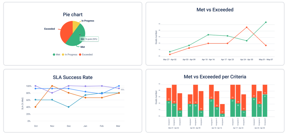

Charts answer a different question: not "what's on fire right now" but "how are we doing over time, and where do we keep slipping?"
SLA Time and Report offers four chart types, each suited to a different level of analysis:
The SLA Statuses Pie Chart gives you the quickest health check – a color-coded snapshot of how tickets are distributed across Met, In Progress, and Exceeded at any given moment. It's the chart you pull up in a stand-up when someone asks "are we okay today?"
The Met vs Exceeded line graph shows the trend over a selected time period – how many SLAs were met and how many breached, week by week or month by month. This is the chart that tells the real story after a process change: did that new escalation rule actually move the numbers?
The Met vs Exceeded per Criteria chart adds a segmentation layer. You can break SLA performance down by assignee, priority, request type, or any custom field. This is where patterns become visible. If breaches cluster around one request type, one team, or one day of the week – this chart surfaces it. Without this level of breakdown, you're averaging out the signal and missing the actual cause.
The SLA Performance Comparison Chart gives you a percentage-based success rate view across multiple SLA configurations side by side – useful when you need to compare Time to First Response against Time to Resolution, or track performance across different projects in one view.

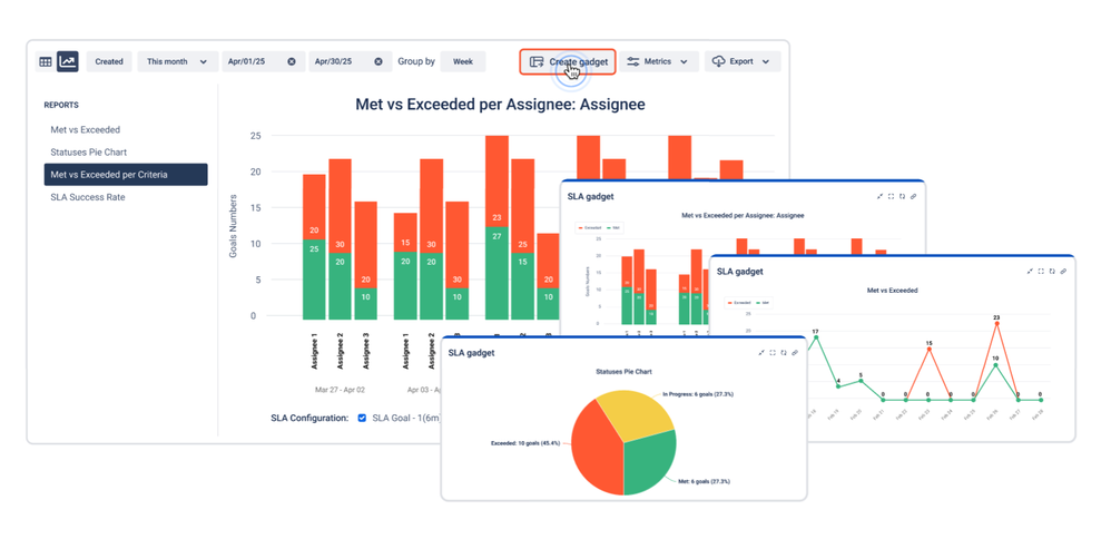

Once charts are configured with the right filters and date ranges, you don't want to navigate into the app every time you need to check something. That's what gadgets are for.
SLA Time and Report lets you add three gadget types directly to any Jira Dashboard: the Pie Chart, the Met vs Exceeded chart, and the Met vs Exceeded per Criteria chart. You can add them directly from the Jira Dashboard gadget picker, or from inside the app by opening the chart you've already configured and clicking "Create Gadget" – the second method is faster because all your filters and settings carry over automatically.
Gadgets support automatic refresh every 15, 20, or 30 minutes, so the dashboard stays current without anyone manually opening it. This matters most for the operational layer – the view your team checks first thing in the morning to see what came in overnight.
