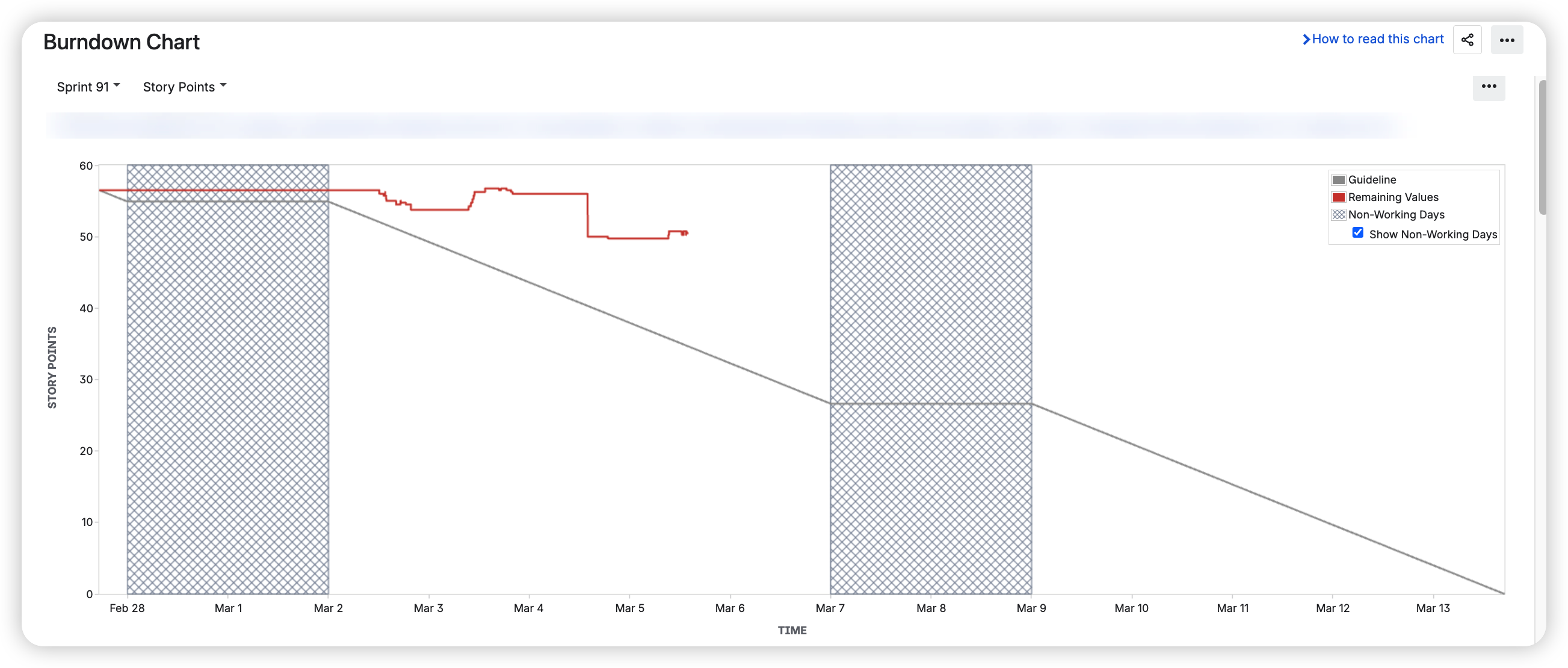

πŸ” How Jira's native Burndown chart works

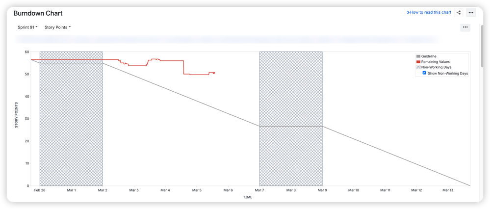

Jira includes a burndown chart in the Reports section of every Scrum board. It plots two lines:
  • Remaining work - updated as issues are completed or estimates change
  • Guideline - a straight line from the total sprint scope to zero, representing the ideal pace
The vertical axis reflects whichever estimation method your board uses - story points, issue count, or time. The chart updates as work is logged, giving a near-real-time picture of sprint progress.

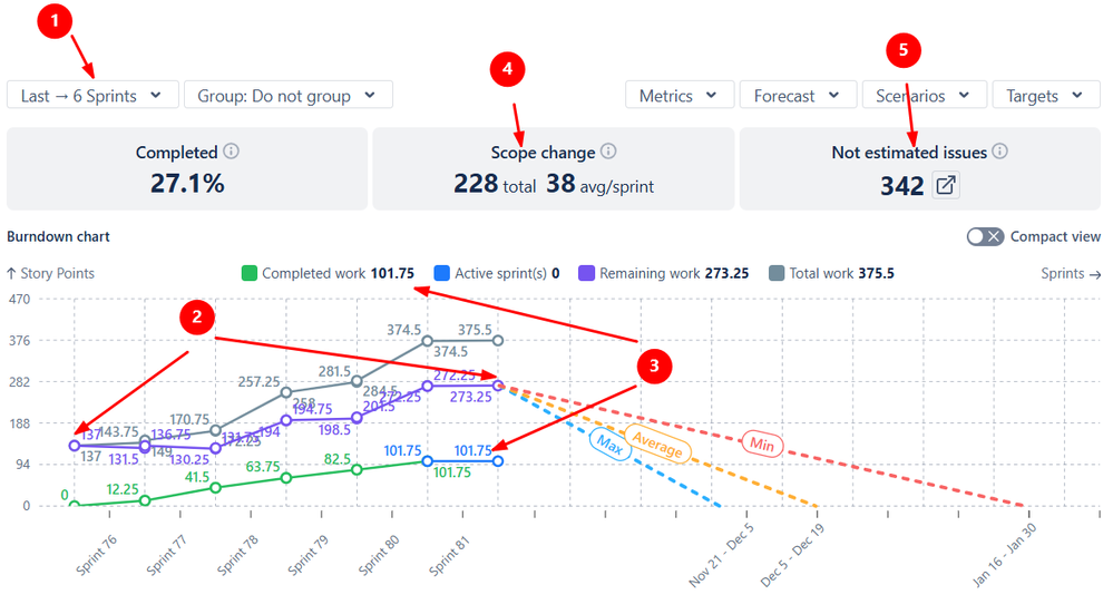

πŸ“Š How to read the Burndown chart for Jira by Broken Build
In the example below, the chart shows burndown for the last six sprints (1️⃣). During this period, the remaining work increased from 137 to 273.25 story points (2️⃣), even though 101.75 story points were delivered (3️⃣). This rise is explained by a scope increase of 228 story points, averaging 38 story points per sprint (4️⃣). In addition, 342 issues in the backlog are unestimated and therefore counted as 0 by default (5️⃣).

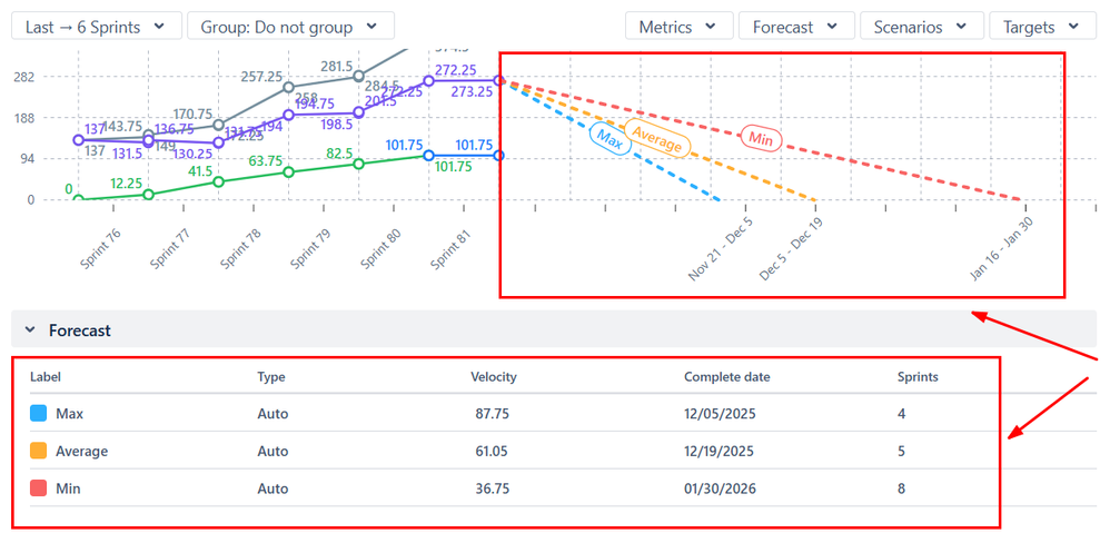

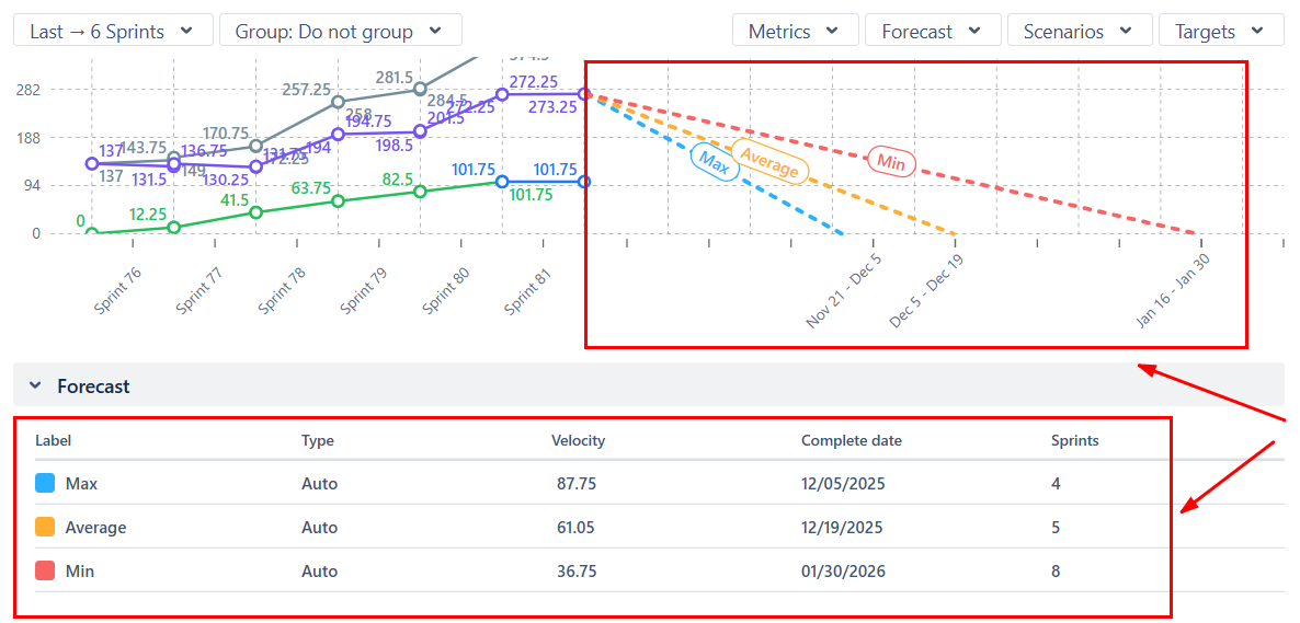

🟣 Forecast lines
Rather than a single ideal line, the chart calculates three completion projections - based on minimum, average, and maximum historical velocity. This gives a range of likely outcomes instead of a single benchmark.

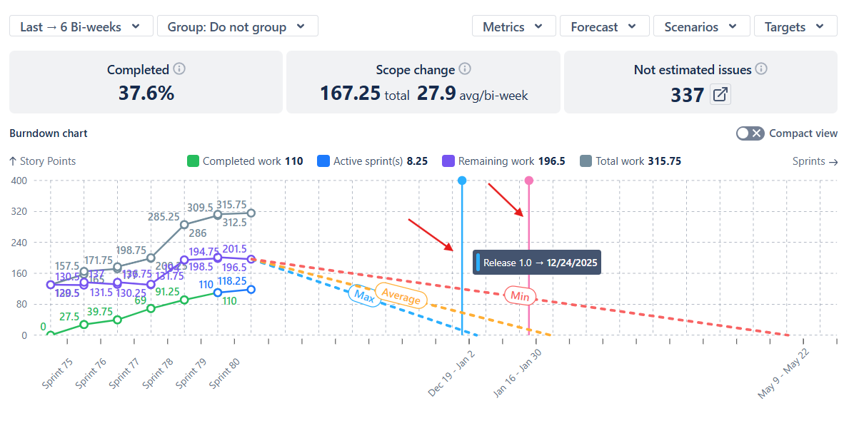

🟣 Target date overlays
Fixed milestones like release dates or PI objectives can be overlaid on the chart, making it easy to see whether the current pace supports the deadline.

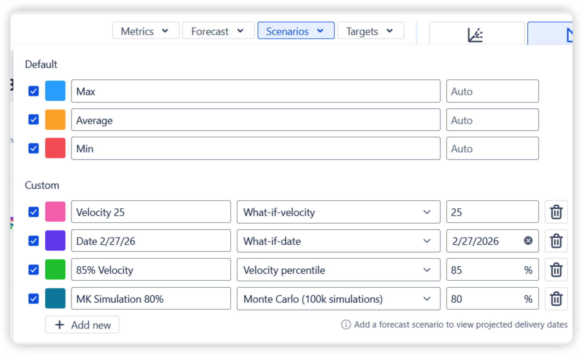

🟣 Scenario modeling
Teams can define custom forecast scenarios to explore different planning assumptions directly in the chart configuration.
In the example below, teams can configure multiple scenario types - including min / average / max velocity baselines, custom β€œwhat-if” velocity or date scenarios, velocity percentiles, and Monte Carlo probability simulations. Each scenario appears as a separate projection, helping teams compare possible delivery outcomes and support proactive planning discussions rather than after-the-fact analysis.

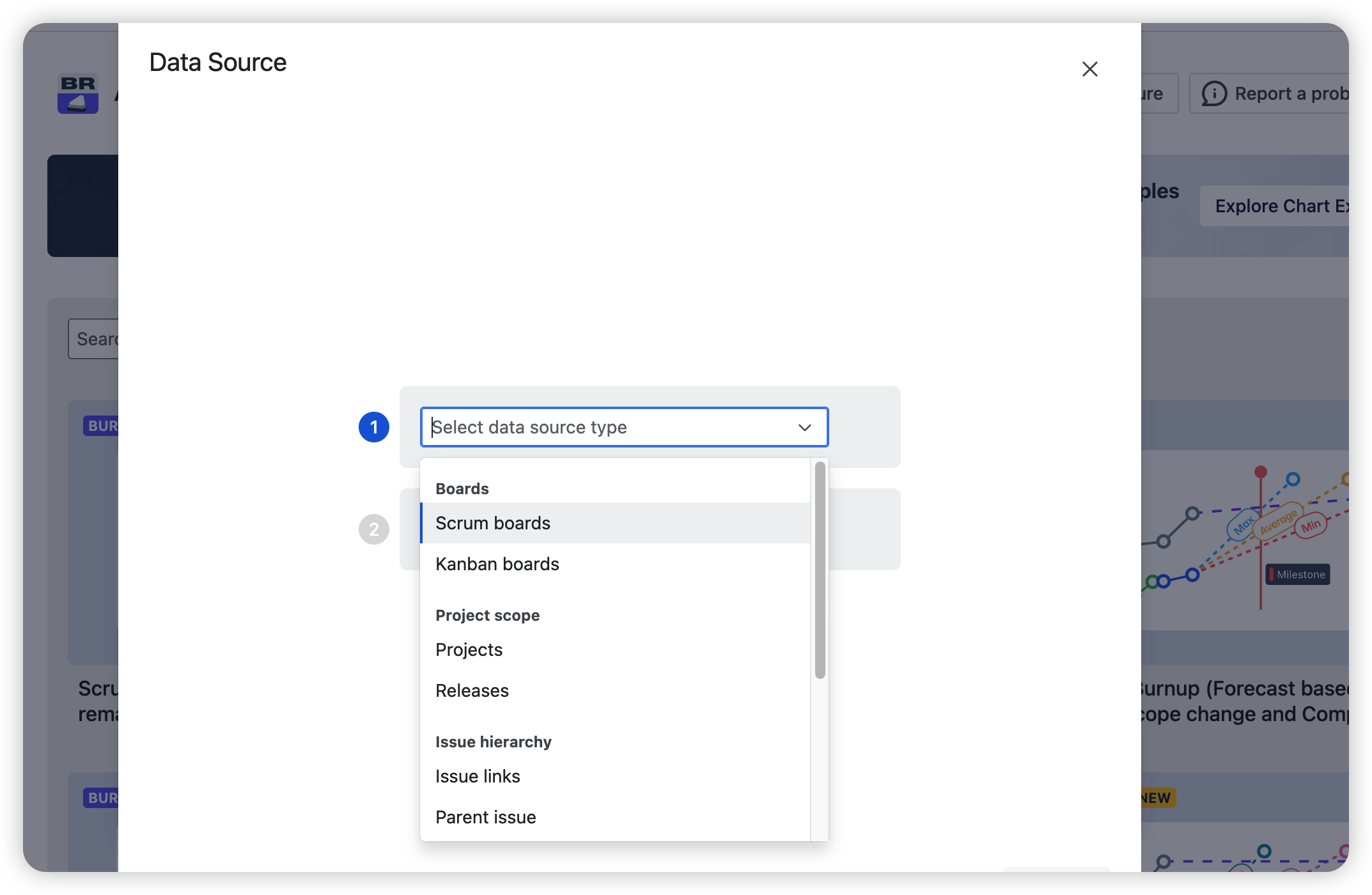

🟣 Flexible data sources
Charts can be built from projects, releases, custom JQL, or parent-level issues like epics and initiatives - not just a single board's filter.

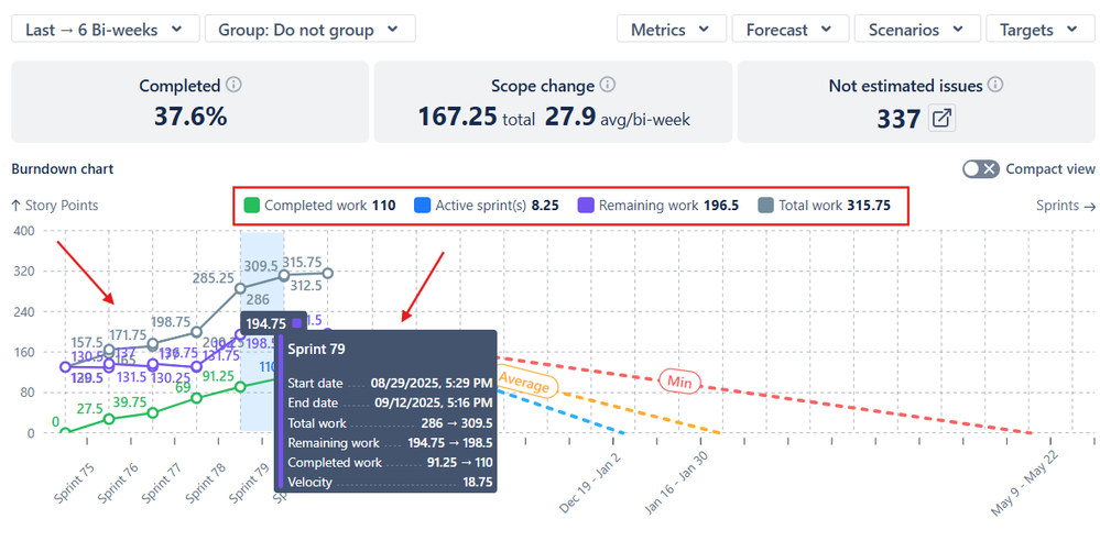

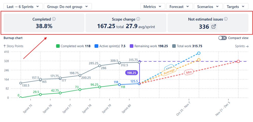

🟣 Health metrics
Health indicators above the chart display completion percentage, scope change, and not estimated issues - giving you an instant status summary without navigating away from the dashboard:
🟣 Progress metrics
Progress metrics are the main Burndown metrics shown on the chart. They help you analyze trends, delivery pace, and scope stability over time.
Hover over any sprint or interval to see how the progress metrics changed during that period:
