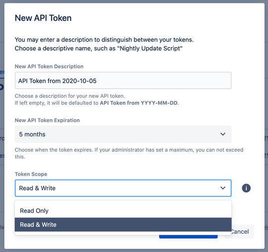

How does it work? We have decided to keep it dead simple.
Just choose whether a token can be used for any API method, or only to read from the database.

Since 1.5.0, the decision to apply one scope versus the other has to be taken every time a new token is created.

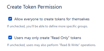

Scopes are applied per token, not per user. However, we have included an option to restrict who can create read/write tokens.
To apply it, navigate to the Permissions tab in the app configuration, then select the box Users may only create "Read Only" tokens.
When the option is activated, only the users with the permission to create tokens on behalf of other users will be able to select the read/write scope when creating a token (either for them or for somebody else).
