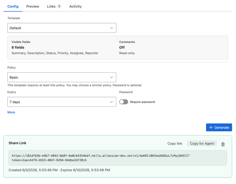

The same share that can render a clean HTML page for a human viewer can also return machine-readable JSON for an agent.
In the product UI, that shows up as Copy for Agent.
Under the hood, it is not a different permission system. It is the same share URL with `format=json`, which means the agent is using the same governed share envelope rather than bypassing it.

Secure Sharing for Jira only returns fields that are visible in the selected share template. The same template that governs the human-readable page also governs the JSON contract. So the agent gets the data it needs, but only within the boundaries that were already approved for sharing.
