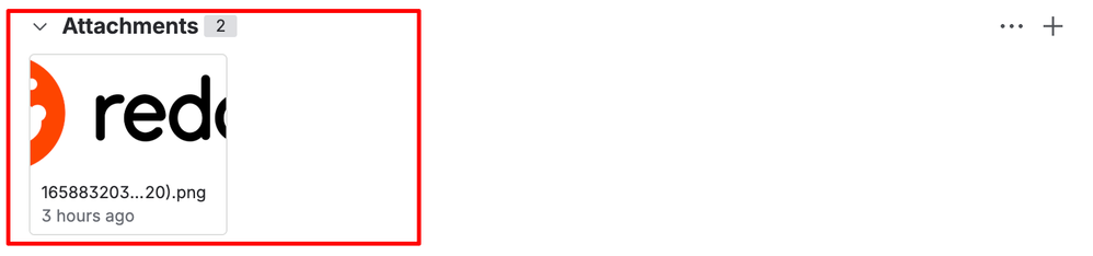

Attachments are files added to a ticket or comment but listed separately, usually below the main message body. They're meant for download and long-term reference.
On Jira, you’ll see them in the work item as a separate field for download.

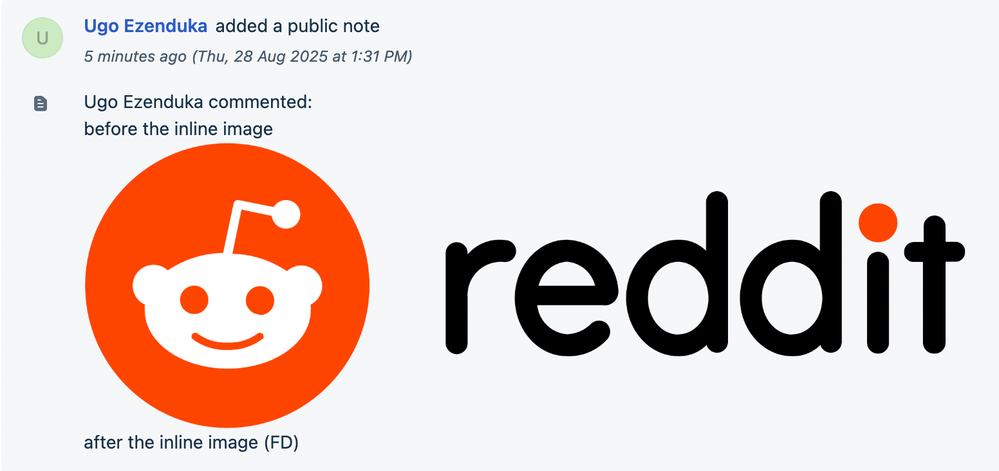

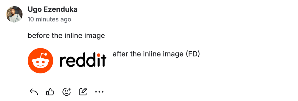

Before we go into detail, let’s look at the use case closely. When you add an inline image to a Jira comment:
The comment will appear on the Freshdesk ticket alongside the image.

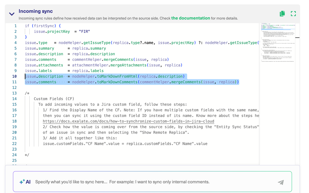

Jira Cloud Incoming
The following code is used to convert the incoming data from HTML to Markdown:
issue.description = nodeHelper.toMarkDownFromHtml(replica.description)
issue.comments = nodeHelper.toMarkDownComments(commentHelper.mergeComments (issue,replica))
The toMarkDownFromHtml and toMarkDownComments methods both fetch the description and comments from the incoming payload from Freshdesk and convert them into Markdown.
