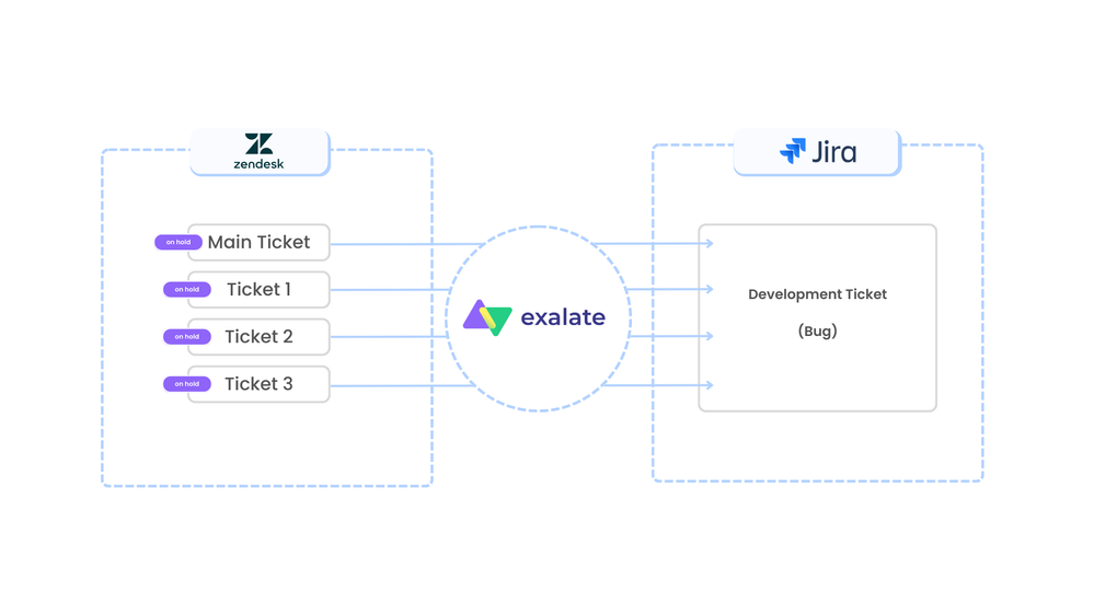

Connecting Multiple Tickets to 1 Issue: Zendesk-Jira Use Case
Every ticket the Support team receives in Zendesk automatically appears as a bug on the Jira side. Other tickets opened subsequently will also map automatically to the same Jira issue – and they’ll appear on the “On-Hold” queue while the development team works on earlier tickets.
Once the development team marks the corresponding Jira issue as “Done”, the Zendesk tickets will receive an automatic update and start appearing as “Open” for support agents to address.

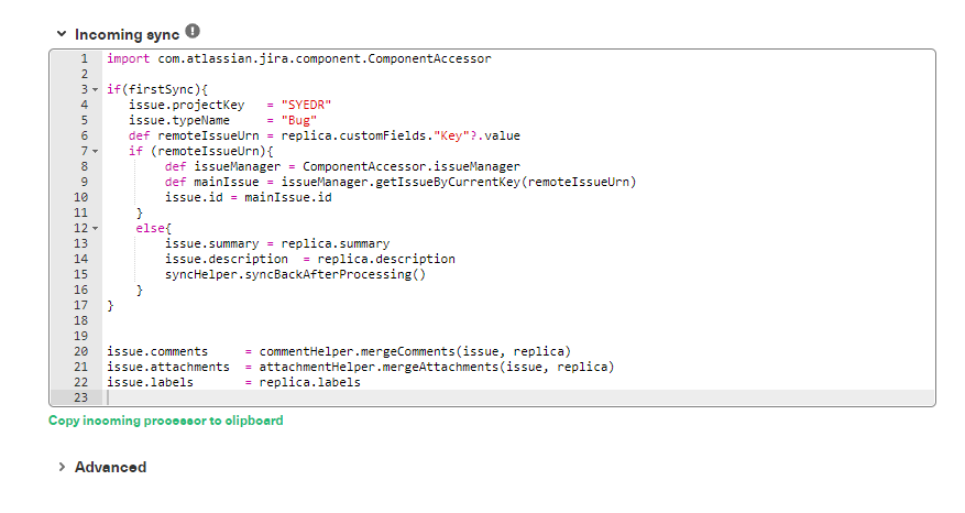

On the Jira side, you need to enter the following code into the “Incoming Sync” text area:
import com.atlassian.jira.component.ComponentAccessor
if(firstSync){
   issue.projectKey   = "SYEDR"
   issue.typeName     = "Bug"
   def remoteIssueUrn = replica.customFields."Key"?.value
   if (remoteIssueUrn){
        def issueManager = ComponentAccessor.issueManager
        def mainIssue = issueManager.getIssueByCurrentKey(remoteIssueUrn)
        issue.id = mainIssue.id
    else{
        issue.summary = replica.summary
        issue.description  = replica.description
        syncHelper.syncBackAfterProcessing()
The above code snippet reads the value of the given field (Key and typeName) on the Jira side and uses the ComponentAccesor to search for the local issue with a corresponding key.
Click on “Publish” to validate the code and establish the connection.
You can download the entire code snippets here.

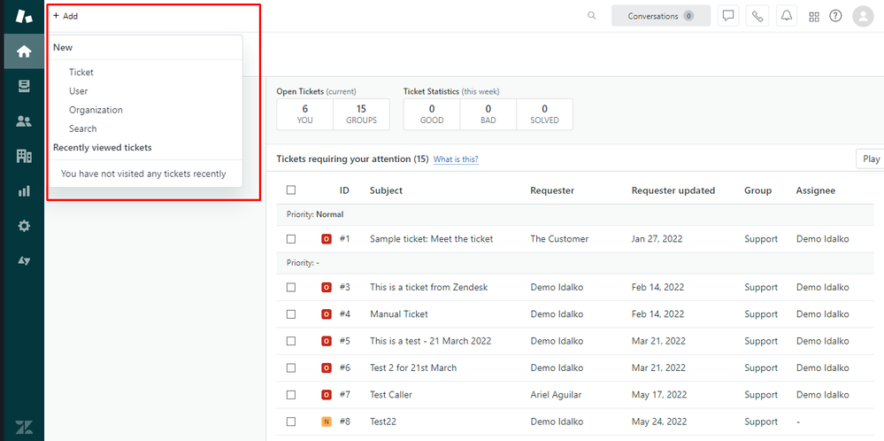

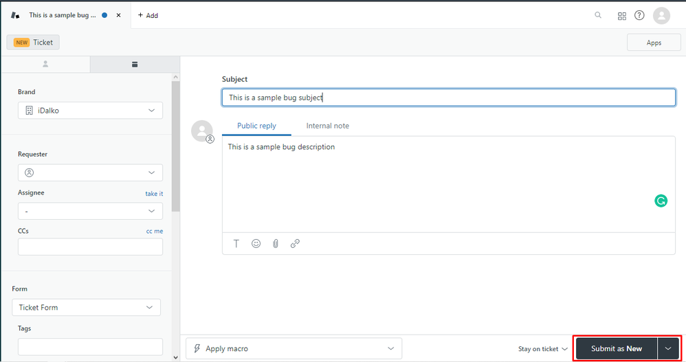

Go to the Zendesk dashboard and click “Add Item” to start. Select “Ticket” from the dropdown menu.
Enter a subject and public reply. You can also change the brand, requester, assignee, tags, and form. Then click “Submit as New” to save the ticket.

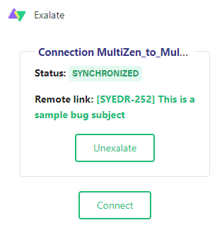

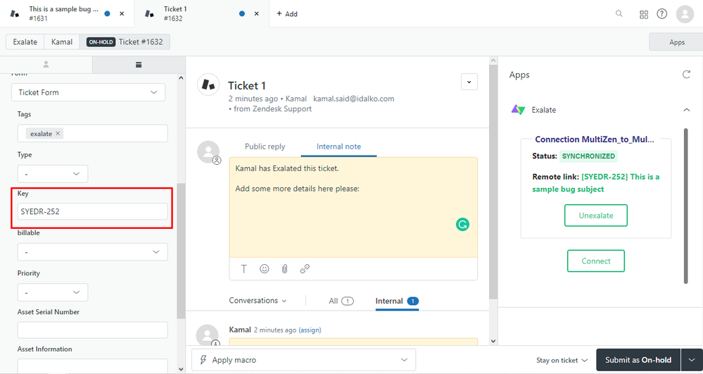

Scroll to the bottom of the ticket and click on “Apply Macro”. Select “Exalate'' from” from the dropdown menu. You will see an internal note showing that the ticket has been Exalated.
The issue key will also reflect automatically in the “Key” input field. Copy this key to your clipboard.
Open a new ticket and paste the copied key into the “Key” input field. Click “Submit as On-Hold” to complete the process and save the ticket.

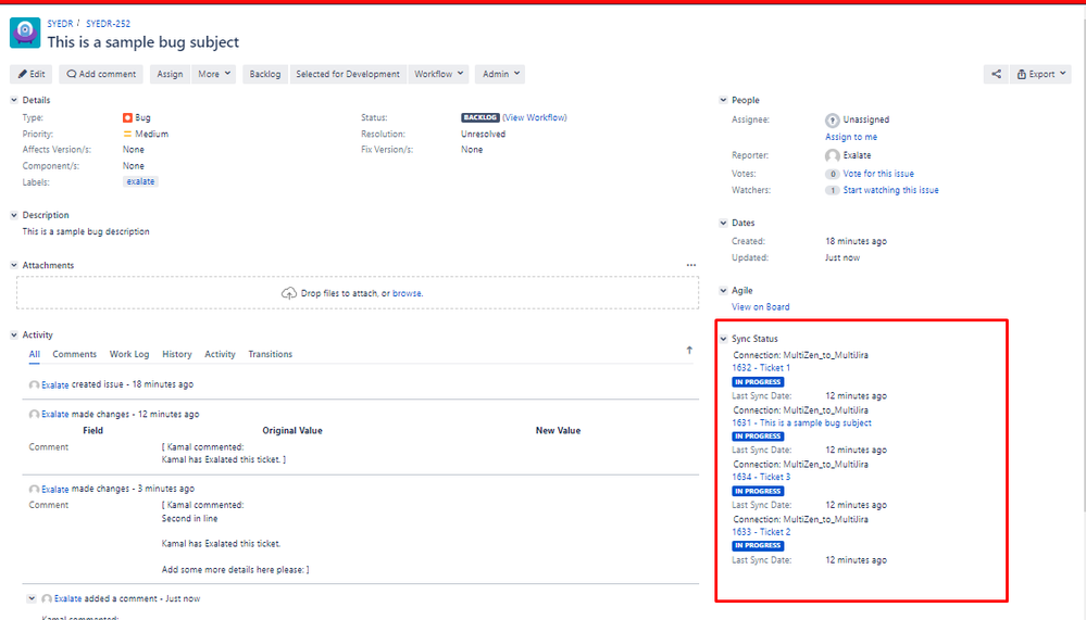

Now, go over to the Jira side and open the issue. Or you can click on the remote link from the Exalate tab on the Zendesk side.
On the Jira issue dashboard, you will see that the three tickets have been added to the issue on the bottom right.

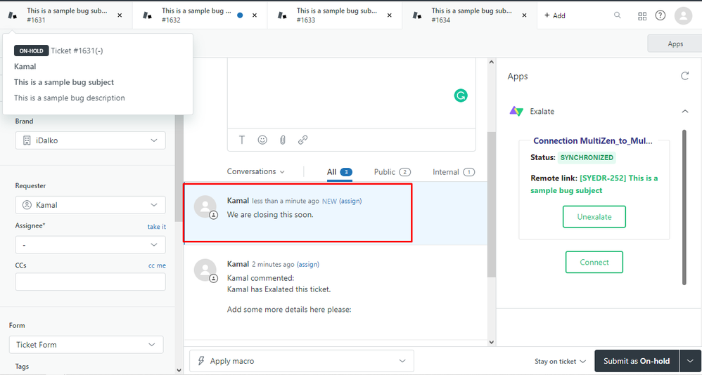

New comments (“We are closing this soon”) added on the Zendesk side will reflect there but not on the Jira side. However, comments added on the Jira side will appear on the Zendesk side instantly.
Why is the setting this way? Because the support team needs to share updates on the ticket–and the developers don’t need to follow this communication.
But when a developer drops a comment on the Jira issue, the support staff needs to see the latest update in order to coordinate their response.

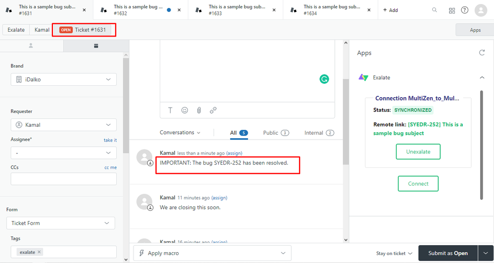

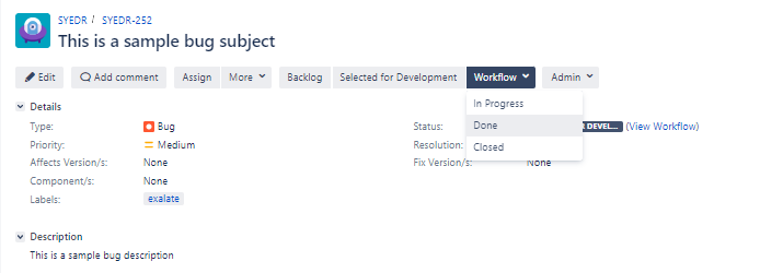

After that, go to the Jira issue and click “Selected for Development”. From the “Workflow” dropdown menu, select “Done” to mark the issue as completed.
On the Zendesk side, this message will appear as “IMPORTANT: The bug SYEDR-252 has been resolved”. The ticket status will also change from “On-Hold” to “Open”.
Click on “Submit as Open” to complete the process and save changes.
