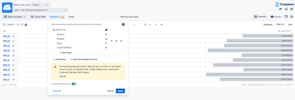

First, you prepare a 'Status Duration' report. Using the 'Statuses' panel, you add a Consolidated Column named 'Cycle Time' and select the statuses that you consider to be part of your Cycle Time metric:

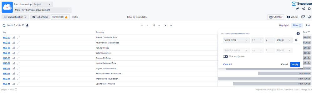

Then use the ‘Filter’ feature of Timepiece and filter the issues in the report to show only the issues that have ‘Cycle Time’ longer than 7 days.
If you are lucky and there are no issues that match that filter, your report will be empty. That is fine. That is probably something to celebrate.

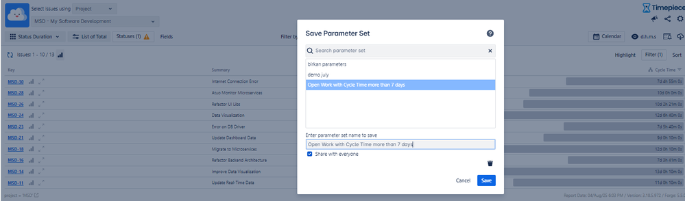

Save your report as a Parameter Set. Let’s name it 'Open work with Cycle Time more than 7 days'.

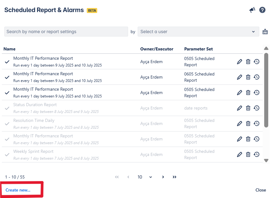

Click the "Scheduled Reports & Alarms" button located on the right-hand side of the toolbar on the main app page.
Create a new Scheduled Report.

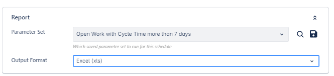

Select the ‘Open work with Cycle Time more than 7 days’ parameter set that you saved earlier:

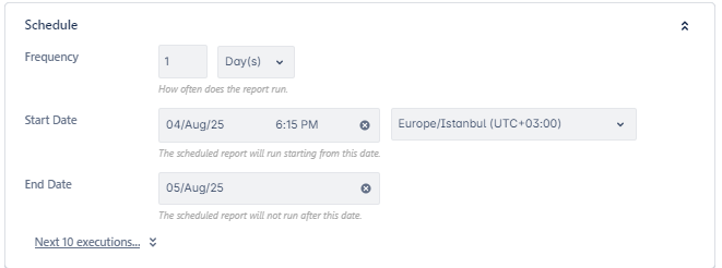

Then, configure the report’s schedule:

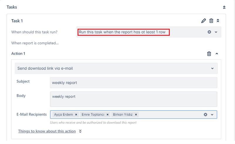

Finally, add an action to your Alarm configuration to send the results as an email and select the recipients.
Don’t forget to set the “When should this task run?” option to “Run this task when the report has at least one row”. This will make sure that you get notification messages only when there are issues in your report. In other words, when there are issues with Cycle Time longer than 7 days.
(By the way, you can send notifications to Slack or MS Teams channels as well)
Save the Scheduled Report configuration and that's it. The report will run on your schedule, and you’ll get a notification only when there’s something worth your attention. If everything is running smoothly, your inbox (or Slack or MS Teams channels) stays quiet.
