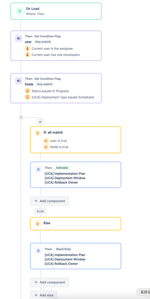

Another example: locking execution fields to the right people
A delivery team wants only the assignee or users in a developer role to edit `Implementation Plan`, `Deployment Window`, and `Rollback Owner` — but only when the status is `In Progress`. Everyone else should still see those fields, but they should be read-only.
As a visual rule in Auto Behaviour:
  • Scope: `IssueView` for the target project.
  • Conditions:
    • `Status = In Progress`
    • AND current user is the assignee, or is in the `Developers` project role
  • IF branch (match):
    • `Implementation Plan` → editable
    • `Deployment Window` → editable
    • `Rollback Owner` → editable
  • ELSE branch (fallback):
    • `Implementation Plan` → visible, read-only
    • `Deployment Window` → visible, read-only
    • `Rollback Owner` → visible, read-only
The key design choice here is that the fallback does not hide the fields. Other users still see the execution context; they just cannot change it. That is a deliberate UX decision that is visible in the rule itself — not buried in a conditional check on line 47 of a script.
