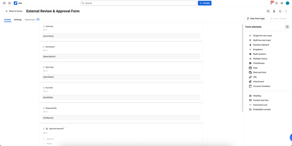

Phase 1: Prepping the "Dynamic Receivers"
Inside the Smart Forms builder, you don’t just build fields; you build placeholders. For any field you want pre-filled (Summary, Budget, Due Date), you simply insert a placeholder like: {summary} or {budget}.
These fields act as "receivers." You can even hide them from the user's view if you want to keep the UI clean while still capturing the data in the background.Screenshot 2026-02-11 at 18.51.18.png

Forget saving drafts. Smart Forms allows you to:
  • Auto-attach forms based on issue type.
  • Generate secure URLs instantly. The moment the work item exists, the form is ready to go—no manual prep required.

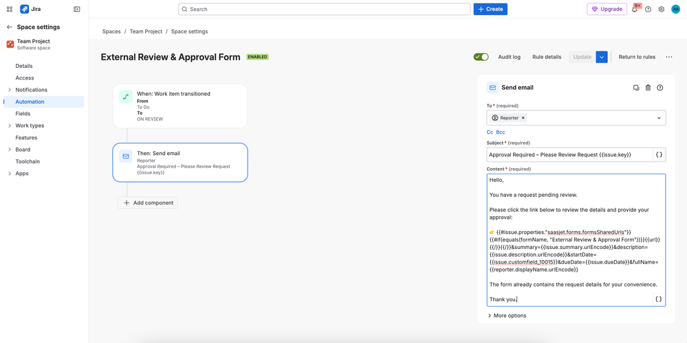

Phase 3: The "Magic" Automation Rule
This is where the friction disappears. You set a trigger—like a status changing to "Waiting for Approval"—and use a standard Jira "Send Email" action.
By appending URL parameters to your form link, you’re essentially "injecting" Jira data into the form: ...&summary={{issue.summary.urlEncode}}&budget={{issue.budget}}Screenshot 2026-02-11 at 19.12.32.png
 When the stakeholder clicks, they don’t see a blank page. They see a personalized, pre-populated form that requires 80% less effort to complete.

Ι've been using it for a while for situations when vendors send proforma invoices and we block limits on cash accounts. After goods are received bookkeeper converts pro-forma request into a real invoice request using an URL created by automation in comment. No need to fill data again, just check if everything is correct.
Link looks like this
https://mycompany.atlassian.net/servicedesk/customer/portal/9/create/468?customfield_11904=Vendor_name&customfield_11908=USD&customfield_11905=3120&customfield_11907=Supplies&duedate=2026-12-23&customfield_12605=FIN-6565&customfield_11910=account_id
FIN-6565 is the original proforma request - it eventually gets converted into a link between proforma request and invoice request.

@s.gridnevskii
Yeah it can also be used like that, but more magic happens when Jira Smart values + Automation come to action and there is no need to even enter the link detalies, but this is more related to the cloud, dont know how this works on DC😌
