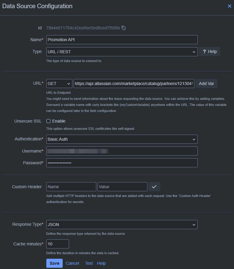

For that, we go to the External Data for Jira Fields configuration under Apps > External Data for Jira create a new Data Source. For Type, we select URL/REST. Then we enter the following URL to the GET endpoint from the Marketplace Promotions REST API, where we retrieve all of our promotions:
https://api.atlassian.com/marketplace/catalog/partners/{YOURPARTNERID}/promotions/paged?active-only=true&limit=1500
You will have to replace {YOURPARTNERID} with your current partner ID, which you can easily find by going to your Atlassian Marketplace Vendor page and copying the number in the URL after /vendors/. In the example of codefortynine the URL is https://marketplace.atlassian.com/vendors/1213041/codefortynine, so our Partner ID is 1213041.
For Authentication, we select Basic Auth and provide the email address and the API key of an Atlassian account that has access to your vendor page and to your promotions page.
Now you click Test and if everything is correct you should get a JSON response with all your active promotions.

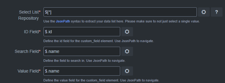

Then you can define all the paths for your field:
Most importantly, the ID field should be set to $.id so we can later retrieve the promotion ID in our automation.
Your Target Jira Field should be set to the custom field we just created and its Status active.

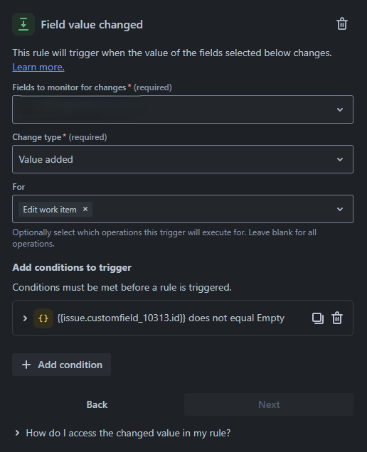

Now, we create a Jira Automation that uses the Marketplace Promotion REST API to create a new promotion code. We can trigger the automation if the custom field we use for our External Data Search Field is changed, and trigger it only if a value is added and if the custom field is not empty.

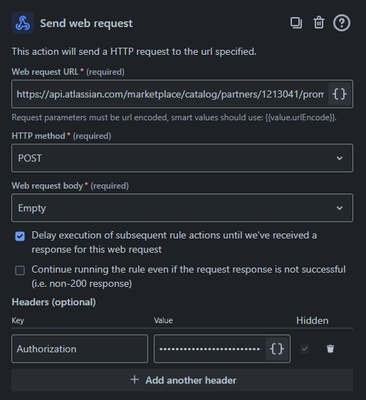

We then trigger a Send web request action. With the following configuration:
Web request URL |
Replace {YOURPARTNERID} with your ID and XXXXX with the custom field ID of the field you use to store your promotion data from step 1 |
HTTP method |
POST |
Web request body |
Empty |
Headers |
Key: Authorization Value: Basic EMAIL:APIKEY The EMAIL:APIKEY part needs to be Base64 encoded. You can generate the Base64 string using tools like https://www.base64encode.org/ or with command line tools:
Also, don’t forget to check the Delay execution […] option. Without it, you won’t be able to use the response in your further automation.

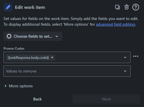

Lastly, we use the {{webResponse.body.code}} smart value to add the newly generated promotion code to the label field with an Edit work item action.
