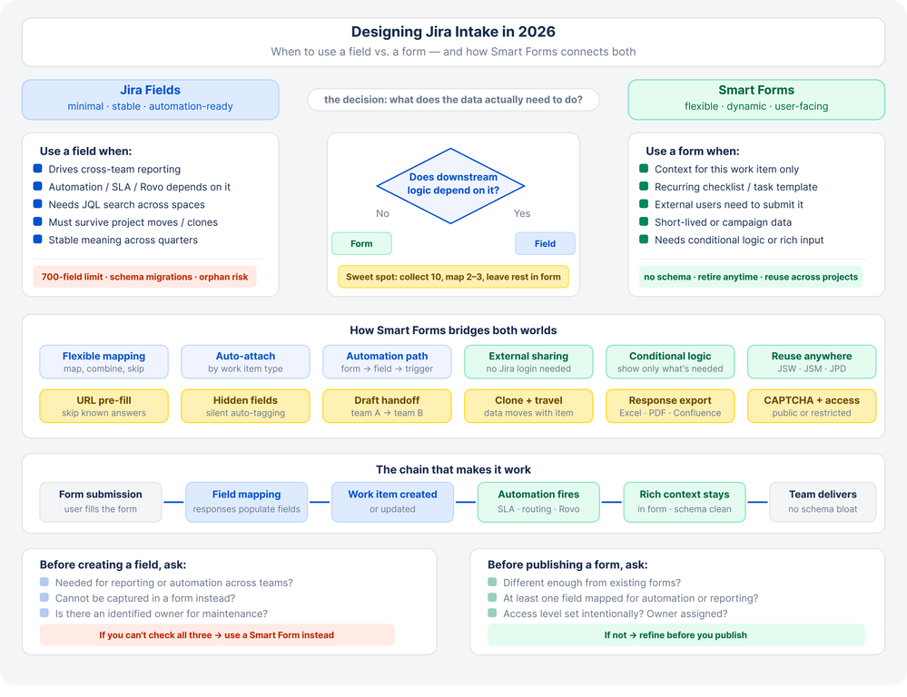

Designing Jira Intake in 2026: When to Use a Field vs. a Form
"We have hundreds (or thousands) of custom fields and nobody knows which ones are safe to delete."
Someone needs to track something. You want to help. Adding a field is fast, it feels clean, and it solves the immediate problem.
But with Atlassian enforcing a 700-field-per-space limit and reworking the field configuration model this year, "just add a field" is no longer a neutral choice. Every field you add is one you'll eventually have to justify keeping — or explain why you can't safely delete it.
But cleanup is only half of the way. The harder question is how you stop this growing in the first place.
Here's the part many teams are only now realizing: not all data belongs in Jira fields. A lot of it belongs in forms — and knowing which is which is the actual workflow design question.
Step 1: Ask what the data is actually for
Not every piece of information your team collects deserves a permanent place in Jira's schema. When a request for a new field comes in, I ask four questions:
  • Will this drive cross-team reporting?
  • Will automation, SLAs, or AI (Rovo) rely on it?
  • Does it need to be searchable in JQL?
  • Does this data need to survive if the issue moves between projects?
If yes to any of those — you're looking at a real Jira field. If no across the board — this is intake context, and it belongs in a form.
That fourth question is the one people miss. Form data is scoped to the form. If issues regularly move between projects and the data needs to travel with them, a field is the safer choice.

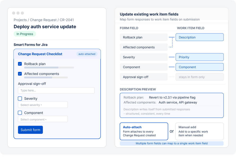

Step 2: Treat forms as task templates, not just intake tools
This is the reframe that changes how most teams think about forms — and the one that's most underused.
In Jira, a "task template" usually means a saved work item someone duplicates and edits. It works until it doesn't — the template lives as a real work item, someone has to remember where it is, and the structure quietly falls apart the moment someone edits it carelessly or skips a field because nothing enforces it.
A Smart Form for Jira attached to a work item is a better approach. Not as an intake portal — but as a structured checklist that lives directly inside the work item, telling the assignee exactly what needs to be filled in before the task can move forward.
Think about a change request. The work item exists. The assignee knows what to do. But does it have the rollback plan documented? The affected components listed? The approval sign-off captured? With a form auto-attached to the Change Request work item type, those questions are right there in the work item — not buried in a comment, not in a Confluence page someone has to find, not assumed.
The form becomes the definition of done for that work item type.
And it works in both directions. Forms can be auto-attached to any work item type the moment it's created — so every Change Request, every Incident Report, every Vendor Onboarding work item automatically has the right checklist waiting. Or a form can be added manually to a specific work item when a particular situation calls for it.
What happens to the responses is flexible too. Every form field can be mapped to the work item Description in a clean, structured format — field name followed by the response — so the description writes itself from what was actually submitted, not from whatever the reporter typed freehand. Or individual fields can map directly to work item fields: the severity selection goes to Priority, the component selection goes to Component, the team dropdown triggers a label that your automation rules read.

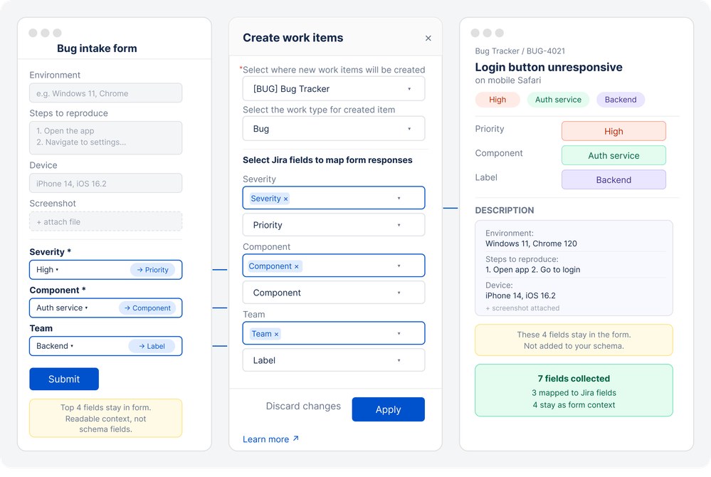

Step 3: Map only what matters — everything else stays in the form
This is where form design either creates long-term value or long-term mess.
Smart Forms for Jira gives you full flexibility in how form responses relate to Jira fields — and that flexibility is worth understanding deliberately:
  • Map a form field to a Jira field — for data that automation, SLAs, JQL, or reporting will depend on
  • Leave a form field unmapped — it lives as readable context in the form response, attached to the issue, visible to the assignee but invisible to your schema
  • Map multiple form fields to a single Jira field — for example, combining "Steps to Reproduce," "Environment," and "Device" into the Description field, so all context lands in one place without creating three separate Jira fields
  • Map a single form field to any custom or system field — for precision routing, like sending a Severity selection directly to Priority or map team field to a label field, any of your choice/
A bug intake form might capture environment, steps to reproduce, logs, screenshots, and severity. You map only Severity → Priority and Component → Component. Everything else stays in the form you can read
The result: lean schema, rich context. You're not carrying every question as a field forever. And when your process changes, you update the form — not the field configuration. No scheme migrations, no reindexing, no "which projects use this field?" .

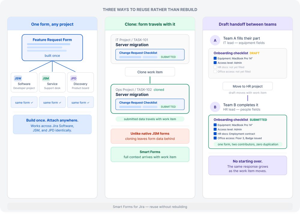

Step 7: Prefer reuse over rebuilding
Before creating a new form from scratch, check what already exists.
Most Jira instances have more form overlap than teams realize. An IT hardware request and a software access request probably share 60% of the same structure. A customer onboarding form and a partner onboarding form are likely 70% identical. The instinct to build fresh every time is expensive — every form you rebuild from scratch is one you'll have to maintain separately when processes change.
Smart Forms gives you three distinct ways to reuse rather than rebuild, and they serve different needs.
One form, any project or Jira product. A form isn't locked to the project it was created in. The same onboarding checklist can be added to a Jira Software project, a JSM service desk, or a Jira Product Discovery board — and it behaves identically in all of them. This means your HR onboarding form works just as well on a support project handling contractor requests as it does on the HR project it was originally built for. You're not maintaining parallel versions of the same form for different teams. You build it once and attach it wherever it's needed.
Clone or copy a work item and the form travels with it. When a work item gets cloned or moved, any forms attached to it — including already submitted responses — move with it. The submitted data doesn't disappear, unlike native JSM forms where cloning a work item leaves the form data behind. This matters for escalations, project transfers, and any workflow where a work item changes hands between teams or projects mid-process. The full context arrives with the work item.
Draft forms move too — enabling handoff between collaborators. If a form has been partially filled but not yet submitted, that draft travels with the work item when it's cloned or copied. This means one person can fill in the fields they own, the work item moves to the next team, and a different assignee completes the remaining fields inside the same form submission. No starting over, no copy-pasting partial information into a new form — the same structured response grows as the work item moves through the workflow.prefer_reuse_over_rebuilding 1.png

The model that actually works in 2026
The best Jira setups I see today follow a simple pattern:
Fields → minimal, stable, reusable, automation-ready Smart Forms → flexible, dynamic, user-facing intake layer
Forms become the interface. Fields remain the data model. Smart Forms connects the two by collecting everything you need, mapping only what matters, and keeping the rest as clean, attached context — without polluting your global schema.
Field sprawl isn't caused by bad admins. It's caused by treating every question like it needs a field. Once you internalize that a form response can live richly without becoming a Jira field — or be precisely mapped to one, or feed several fields at once — you stop reaching for new fields by default.
