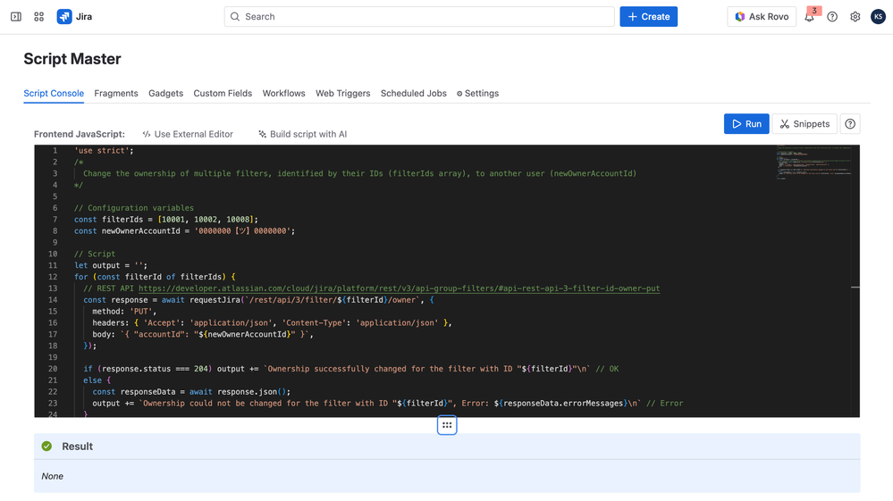

Script Master for Jira is built around a specific idea: Jira administrators should be able to write and run scripts in the browser, using their current admin account, without setting up anything locally. Script Console is the module that makes this possible.
“Script Console” is a code editor embedded in the Jira admin interface. You write JavaScript, click Run, and the script executes inside your Jira instance under your permissions, with access to Forge bridge APIs and the full Jira REST API. Everything runs inside Atlassian's infrastructure - no data leaves your cloud environment.
Script Console is built on Forge Custom UI, so all scripts you write are Forge-compatible. If a script grows complex enough to warrant a standalone app, you can take the same code and migrate it to a proper Forge app without rewriting anything.
Getting started
Open the Script Master menu in Jira and click Script Console. You'll find a full code editor with syntax highlighting and autocomplete. From there you can write from scratch or use the Snippets Library, which includes ready-to-paste examples for common admin tasks, each linking to the relevant Atlassian REST API documentation.
For most tasks that come up in day-to-day admin work, the Snippets Library has something close enough to adapt. Reading a snippet alongside the API docs gets you to a working script faster than starting cold.
