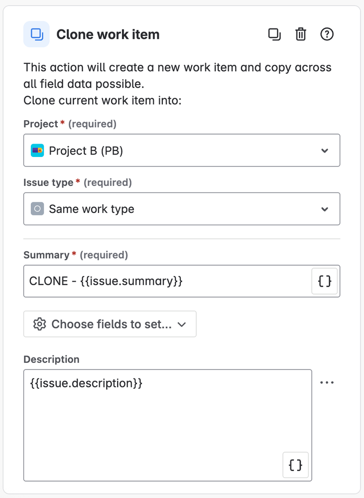

1. Create a New Jira Automation Rule
  • In your source project (where the original work item will be created), go to Project Settings > Project automation > Create rule.
2. Set the Trigger
  • Choose Work item created as your trigger.
3. Add the Clone Action
  • Click New action and select clone work item.
  • Choose the target project (Project B in our example)
  • Map the Jira fields you want to copy from the original work item (summary, description, etc.).

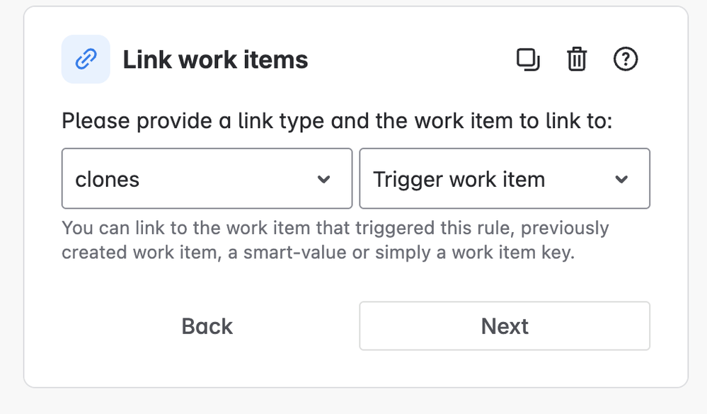

6. (Optional) Link Work Items
  • Add another action: Link work items.
  • Set the link type (e.g., “clones,” “relates to”) to connect the original and cloned work item.

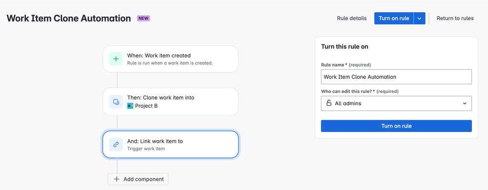

7. Name, Save, and Turn On the Rule
  • Give your rule a clear name.
  • Click Turn on rule to activate.
Result
This automation creates a new, cloned work item in the target project whenever a work item is created in the source project, keeping relevant details consistent and allowing independent tracking.
Important to Know
  • This is a one-time clone; subsequent updates to either work items won't automatically sync.
  • Two-way syncing and cross-instance automation require significantly more complex setups and maintenance.
