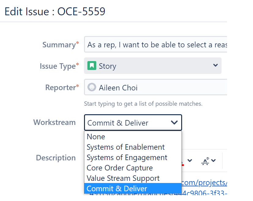

I like Fabian's approach as well. @Fabian Lim, can you elaborate more on using the custom field to select the board? I've used Components for this same purpose but your approach sounds like it solves a problem I have where people inadvertently create tasks in the wrong project and/or board.
Here is the customfield which is a select field:

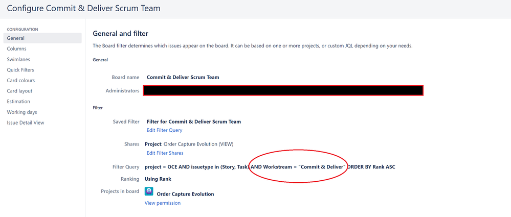

And this is how you would set your board filter:
Each board needs to have the workstream specified.
@Fabian Limthanks for the quick reply. I was thinking you were using that field in some sort of automation operation to force a new issue into the correct project and workflow. I kind of misread what you meant by workstream.
