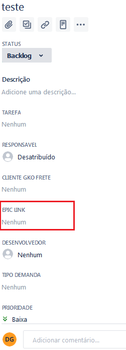

I don't think I explained it very well, I need to directly filter only my epics in the field. The ones in the red rectangle are mine and the green ones are from other projects, I want to bring only mine.

So, I created the filter, it brings the epics right, but my boss wants to set it right on the card, like when a task is created, he wants to define her an epic that he created, but the epic link field is used by other parts of the company, so when he goes to set the epic for the task, he brings these other epics from other projects. He wants to come to the card field only what he created, unfortunately it is not to create a panel, so he wanted to know if there is any way to do this in the field inside the card.
But thank you for the other answers.

For the built-in Epic Link field the selection of Epics will be all the issues which are visible in Jira to your boss.  If you want give your boss an Epic Link field that is constrained to only those they have created then you will need to create a custom field based on a JQL query such as "creator=your.boss and issuetype=Epic".  Then have the value of that field replace the value in the built-in Epic Link field.
To create such a custom field you will need a 3rd party app such as Script Runner or Elements.
