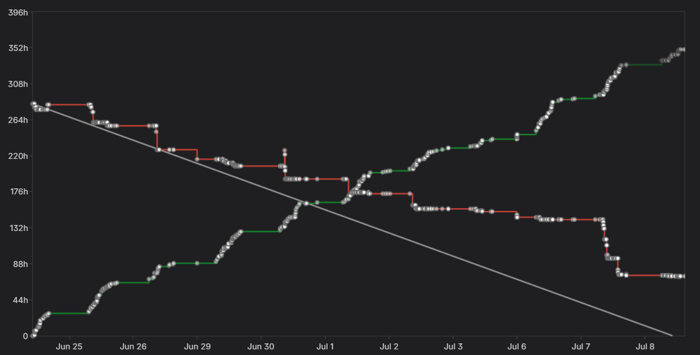

Over time, I’ve consistently faced a reporting dilemma with Jira's standard Burndown Chart:
In a typical sprint, we see the Original Estimate line go down, while Time Spent climbs. In reality, Time Spent often shoots far past the original estimate, while the estimate line rarely hits zero because planned scope was left unfinished.
The core issue: The burndown line only jumps upward when estimated tickets are added mid-sprint. However, the majority of unplanned work consists of urgent bugs, ad-hoc support, or small operational requests that are added without an estimate (or with 0h).
A classic example from one of my past sprints (see image above):
  • Planned scope started around 270h, but ~80h remained incomplete at sprint end.
  • Notice specifically the second week (starting around July 1st): While the remaining estimate line almost stagnates, the Time Spent curve spikes massively all the way up to over 350h.
  • In this specific case, that divergence was caused entirely by incoming unestimated tasks, urgent operational requests, and support items that absorbed the team's capacity without moving the planned burndown.
  • To an outside stakeholder looking just at remaining estimates, it looks like a missed commitment — while in reality, the team delivered ~350 hours of pure output, mostly absorbed by untracked shadow work.

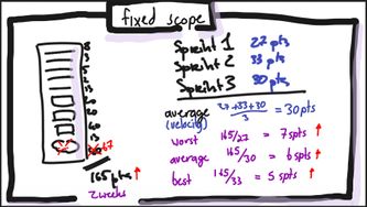

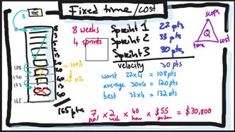

Suggestion: Teams should ideally commit to Outcomes not Outputs in planning (the only known at that time is what's important, and that we can't predict the future so the plan will change). Set a goal using language questions like "What will be different at the end of the sprint? How will we know we achieved it? If we delivered every item, what would make our customers celebrate?".
Suggestion: Estimates are a fancy term for a guess, so make ranges explicit. If using points, your velocity is not a single number but a range based on probability:
  • Worst: Least points delivered in a sprint
  • Avg: Avg points delivered over last x number of sprints
  • Best: Most points delivered in a sprint
When forecasting, the script changes from "will be delivered in 4 sprints", to "will be delivered between 2 and 6 sprints, with a high probability being within 4 sprints".
  • If working towards a specific release date the question stakeholders should ask is not "is this on track", but "what will I get on release date". This shift and the ranges above can shift the narrative of a burnup: "looking at our estimated backlog, we can deliver between 60-80% of the backlog based on what we know right now. This encourages the PO and stakeholders to ensure the most NB! items are in the 60% and lets them know early that, based on data, anything beyond the 80% in the backlog will not be delivered. Any unplanned changes or new requirements can then be compared to those ranges.
I've tried to illustrate these scenarios below with some dummy data (apologies for the handwriting).
I'm working off a lot of assumptions based on my read of it, so feel free to question/challenge/contextualise in response if I've entirely missed the mark.

First off, thank you so much for the detailed reply and for taking the time to share those illustrations — really appreciate the perspective!
You hit the nail on the head regarding the cultural aspect: tooling will never replace courageous conversations, and committing strictly to outputs rather than outcomes is a trap many organizations fall into. Forecasting in probabilistic ranges (best/worst/avg) is a fantastic way to reset stakeholder expectations around scope vs. time.
