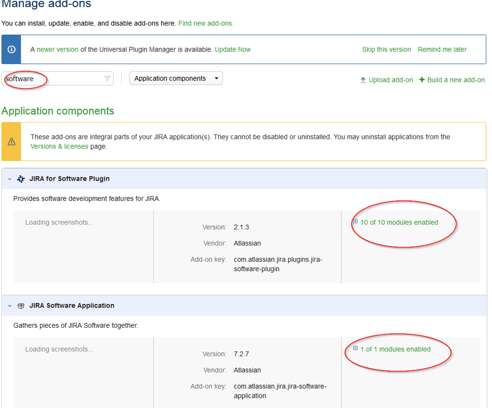

  1. Can you check on the "Versions & licenses page if Jira Software is installed? (not only licensed)
  2. Also check on the "Manage Add-ons" page if the application components are enabled by filtering for "Application Components"
  3. Check your log files for any errors at the time of your startup. Some crucial parts might not have been enabled successfully

1) On the versions and licenses page the Jira Software entry is listed.
2) In the add-on modules page, we can see both Jira for Software Plugin and Jira Software Application entries. Under each of these the modules are all enabled.
