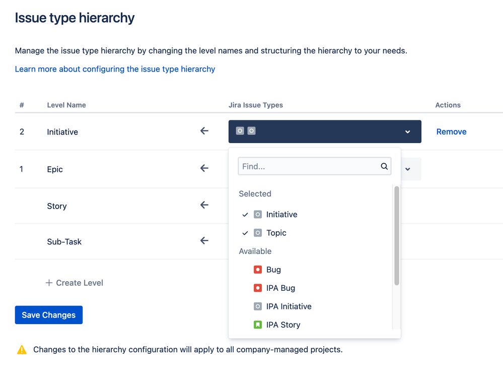

It's not possible for you to view Topics above Epics on your roadmaps without changing the hierarchy. However, when configuring your hierarchy it's possible to have multiple issue types on the same hierarchy level, so you could use the setup shown below where you have both Initiative and Topic on the same level.
This will not relate your Topics and Initiatives at all - it will just allow you to use either a Topic or an Initiative as the parent for an Epic. I'll note that issues can only have one parent though, so it's not possible for an Epic to have both a Topic and an Initiative as a parent.
Hope this helps! Let me know if I can clarify anything further for you.

I didn't know it was possible to add another issuetype on a same level, that's good to know. Unfortunately, it won't work for me: in our way of working an Epic is forced to have a parent Initiative so it can't have Topic as true/single parent (that's why the only link type we set up so far is "Epic implements Topic" but "initiative is parent of Epic".)
