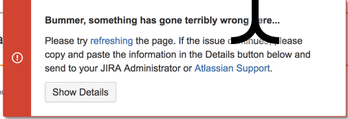

Okay, so this appeared to be the potential issue, the Initiative in question was not selected. So...
- I selected it
- Tried to move to the next step, step 3 but got this error on page...
Any ideas?
Thanks,
Jake
Walter Buggenhout
September 2, 2017
One thing you might check, is whether all issue types in the project selection are configured in Portfolio's Hierarchy Configuration.
All issue types you import, must be mapped to a hierarchy level. You find this in the Administration section of the Portfolio addon (In the JIRA menu: Portfolio / Administration and then Portfolio Hierarchy Configuration.
If it's not that or you can't figure it out, do what the error message says and send the details of the error to Atlassian support, so they can help you figure out what went wrong exactly.
