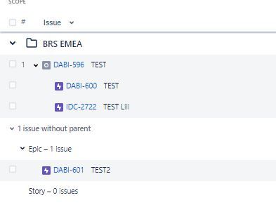

I have been struggling with this issue for some time now and looking to get some help. I have been working to link different JIRA using parent/children so they reflect on the portfolio view. I linked the items, within each tickets and can see the relation updated in the ticket. However, I still do not see the item showing in the drop down of the parent tickets. For the two that are showing, it is only after I manually dragged them over.
To note, I am using a filter instead of a project as looking to pull from multiple projects but I have also tried only having one defined project and it was still not working.

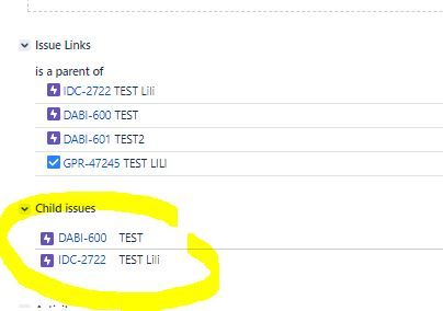

I compared a child that I dragged over and one I have not and they are exactly the same. However, in the parent ticket, the child I dragged show up differently (3rd screenshot)

Your screenshots look a little unusual to me because I wouldn't expect to see the parent link shown under issue links - but rather just in the child issues section.
Can you confirm how you're creating the relationship between DABI-596 and DABI-601? Are you using the parent link field provided with Portfolio / Advanced Roadmaps or have you created a custom link?

I have tried a 2 ways to link  create the relationship
1. Directly created the child ticket via the parent ticket using  'create linked issue' in the parent JIRA and just created an epic link from there.
2 Clicked on the little + link across 'Issue Links' and linked my existing parent with my existing child tickets.

Issue links and parent -> child hierarchies are different things.
It sounds like you are linking issues and whether the link is called 'parent of', 'child of' or 'first cousin of' doesn't matter in terms of hierarchy - they are a just words used to label the connection between two items.  Remember: the tasks and stories in an EPIC are not issue links they are in the EPIC as a hierarchical relationship.
If you want to create the parent -> child relationship within a (child) issue you need to use the EPIC LINK field on the issue screen (for tasks/stories to EPIC) or the PARENT LINK field on the issue screen (for EPIC's to their parent issue type e.g. Initiative)
Similarly, from an EPIC screen you'd use the small + sign next to issues in EPIC to create new issues from within the EPIC
Within the Portfolio plan view, you can simply drag and drop a 'child' issue over a 'parent' issue to create the same relationship (remembering to save your changes back to Jira)

@aurelie Beltrando one other thing that might not be obvious is that if you want to be able to set parent links from within the issue details screen then you'll need to add the "Parent Link" field to the screen (and depending upon your setup you might need to do this for multiple screens). You should be able to use the "Where is my field" link when editing an issue and this will help you identify if the Parent Link field is present and if it isn't, provide guidance on how to add it.
As @Paul O describes - a parent link is not a standard issue link, it is a hierarchical link that is very similar to the epic link.
