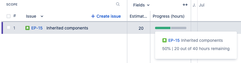

To provide a more concrete rationale... imagine that you start a piece of work in one sprint that is 40h long and you complete half of it by the end of the sprint. You need to finish it in the next sprint so when you're planning do you assume it's still going to take 40h or do you plan for the remaining 20h of work?
This is basis of why Advanced Roadmaps looks at the remaining estimate. However, it is possible to access the data from the "Progress (hours)" field, as shown in this example.
Here you can see that the remaining estimate is shown (20h) but the progress field is showing the original estimate data.
Regards,
Dave
Like # people like this
