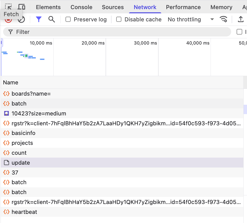

Until then I can share that I've made good experience with using the internal REST endpoints that the browser uses in the background when you apply changes to the plan through the UI.
In case you're not familiar with how to do this:
- Open the Network Tab in the Developer Tools of your browser. Load the configuration page where you'd manually would the adjustment that you want to automate. Wait for the page to load. and then clear the network tabs contents.
- Now perform the action and look for the "update" request in the network tab:

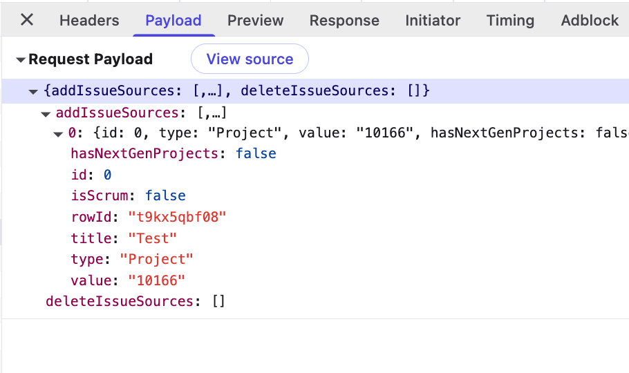

- Click on this request and copy the URL and the Payload. By adjusting the payload and using this internal REST endpoint, you should be able to automate what you're looking for.
Those internal endpoints should always be used with caution, but for this particular one I can tell you that I've built production automations for clients years ago and they still run to this day. So it doesn't seem to be changed; and if so, Atlassian hopefully versions them properly, so that using version 3 will grant you a stable endpoint.
