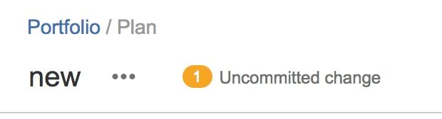

You can install Portfolio in your current production it will pull data from your Jira and is basically a layer that sits on top of your projects to show you the high level project plan.
However, if you don't want it affecting the projects, you should never commit the uncommitted change back to your Jira (this is a button in the plan that will ask you to review and commit the changes once you're happy with it)
uncommittedbutton.jpgClicking that button will take you to a screen to review and commit changes, so if you don't want to do any changes back to production you should not click on this.  Uninstalling portfolio will have no affect on your projects as long as you don't commit changes.
